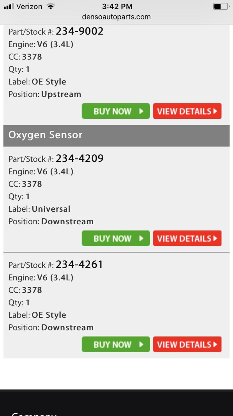

Got both these sensors in and just for the record these are the incorrect ones on the wiring harness end.
Pic is from denso website but they both are listed downstream

Downstream sensor replaced this weekend and from the first quarter of the tank seems to be back to where it was before the MPG drop but will need to wait until I run a full tank.
Correction downstream for 01 SR5 is Denso 234-4261
Glad you seem to be back on track with the mileage However, I am somewhat confused. Did you use the same part# sensor for the fore and aft positions? Also, is it 234-4261 or 234-4162?
234-4261 ordered and goes in no prob, also I know few said don’t pay attention to the amazon part match but it did verify it was the downstream. It is the threaded sensor, the upstream is held in by two 12mm bolts with a gasket and it is 234-9002
