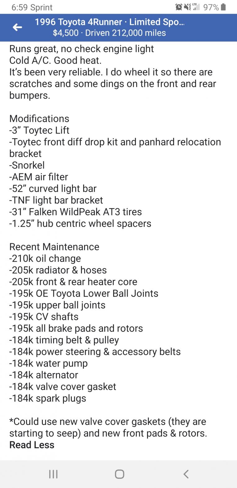

Timing belt and all that was done at 182k vehicle is now at 212k the previous owner said it's always done it since hes owned it. I'm gonna take off all the belts again tonight and try everything.
you say timing belt was done but don't mention the pulleys, idler or waterpump. Some say that they should be done on every 2nd or third belt swap.
Mine is on the third belt, no records of any of those items being replaced, even though the work was done at dealers ( by po) so when I did mine at roughly 180k, I replaced every movable part related, including the a/c idler pulley, which is often not done with timing belts and not included in kits. Also did the cam and crank seals.

Heres the list of what he did to it.
