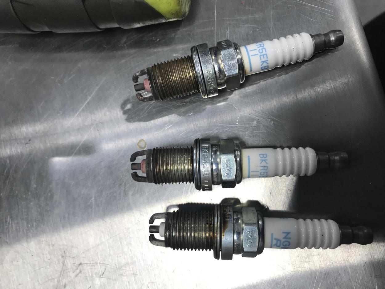

Went ahead and decided to test the resistance of the injectors today and they were all in the 14-18 range, which is spec according to the FSM. I also decided to pull the spark plugs to check their wear and sure enough, cylinder 1 was a lot more white Han he rest, indicating that cylinder to be running lean. This cylinder happened to also get a code for a misfire about 5 months ago but never came back when cleared. I’m staring to suspect injectors now.

Well I went ahead and did the fuel injector/fuel rail replacement today. It did not go as simple as it should've (as usual), however I managed to do it all in under 2 hours and that was with taking the intake off 2 times.
Once I swapped the rail/injectors over, I started the engine and it was missing BAD, so I was like what the hell. for shits and giggles I pulled the electrical connection for No. 1 injector and nothing changed. Okay, so that "new" injector isn't working. Tear it all down again and I put one of my old ones back in to cylinder 1. Put it back together and it was still surging and missing bad at idle, but smoothed out once I gave it gas. I wanted to be done at this point, so I just checked for vacuum leaks since I was getting a code for all cylinders missing. Sure enough I forgot to tighten the upper intake all the way :ybrick:
On the bright side, the jerking feeling I had seems to be almost completely gone and if I do feel it it's very subtle. I put some fuel injector cleaner in the tank so I'll let that do its magic.
