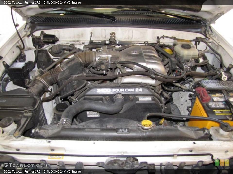

My antenna works perfectly oddly enough. I don't think it's the antenna motor because (at least from the interior of the truck) it sounds like the noise is coming from behind the dash or something. Maybe it's that cylindrical black piece in the top left of the engine bay. I don't know what that is. I wish I had a diagram of EVERYTHING in the engine bay. I mean everything, not just main parts - every hose, wire, etc. and what they do, where they go, etc. It would make my life easier. That's not my engine bay by the way.
