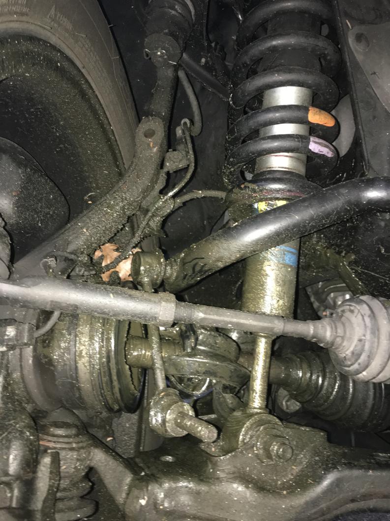

Found the problem.
The right sway bar end link broke and was hanging down rubbing on the axel.
The local shop said I should replace both the sway bar link and the axel.
Can anyone give me advice on getting a new axel?
New? Used? OEM? Aftermarket?
I don't know much about this. I want quality, but don't need to waste money.
Photo of the break is attached.

I guess I will take their word for it if they say it broke... though to be honest it looks more like someone forgot to put the nut back on (usually they break on the little shaft between the two joints before they break anywhere else...), but the picture quality and grease makes it hard to be sure.
But yeah, that's basically why you can't have traditional style disconnects and why having some beefier sway bar links if you do go off-roading and want to retain on-road manners is not a bad idea.
As for axle replacement, I would go with Toyota as it's the best replacement axle next to say CVJ (also pricey). A lot of the Napa, Autozone, ect. shafts seem to be for the most part hit or miss off-roading from what I've seen a lot of people posting; but if money is tight and the vehicle is not going to be used heavily off-road you might get away with one of those cheaper units. I would agree with the shop though that the shaft should be replaced, I know it's a big piece of metal and it looks okay for the most part, but all those metal shavings and the sway bar link bouncing off of it just introduces too much possibility of expedited wear to feel comfortable about just rebooting it.
Best of luck!
Best of luck!

If the nut came off, that would be on me, since I did the work myself to add the billy 5100 & FJ coils. I *know* I put the nut on, but I may have forgotten to tighten it... Oh well, my (costly) mistake. At least no one was hurt!
I have new heavy duty sway bar links coming from [MENTION=98153]MStudt[/MENTION], so I'll get a new OEM axel and I should be good.
Thanks [MENTION=66389]BlackWorksInc[/MENTION], and @CXS for the info and advice, especially confirming that I should go OEM on the axel, and also explaining why.
