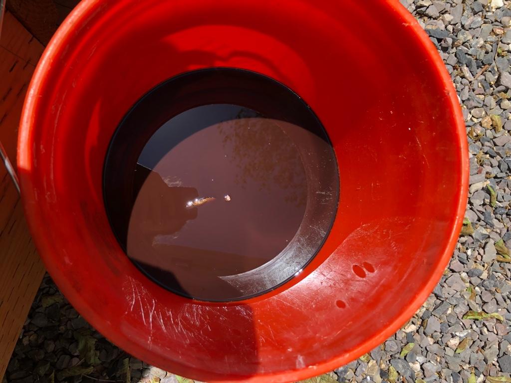

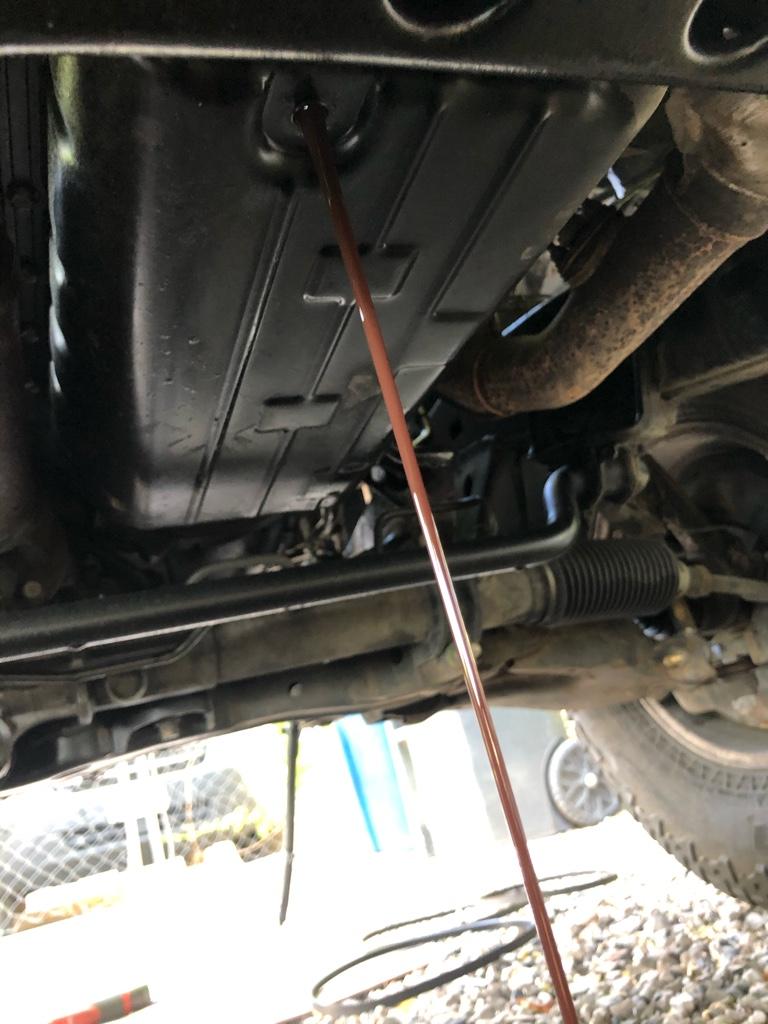

Thanks for the replies all, yes here’s some pics I forgot to attach. I’ll start to plan/budget for a new trans then if it’s only a matter of time. I wanted to do a manual swap so I guess this kind of pushes it to more of a need haha
Only picture I got while draining it from the trans.
Bucket of coolant or whatever came out of the radiator, same stuff came out of the transmission send and return lines of the transmission. I wouldn’t say it’s super milky but I’m pretty sure that they’ve mixed. Where the upper and lower radiator hoses attach to the motor it was definitely more milky and kind of had a deposit of sludge I would say.
IF the transmission fluid is the exact some color as your coolant very good possibility of mixture. As neither should look milky. But they both go from Red to Dark brown in time. Provided the coolant is Toyota Red instead of green.

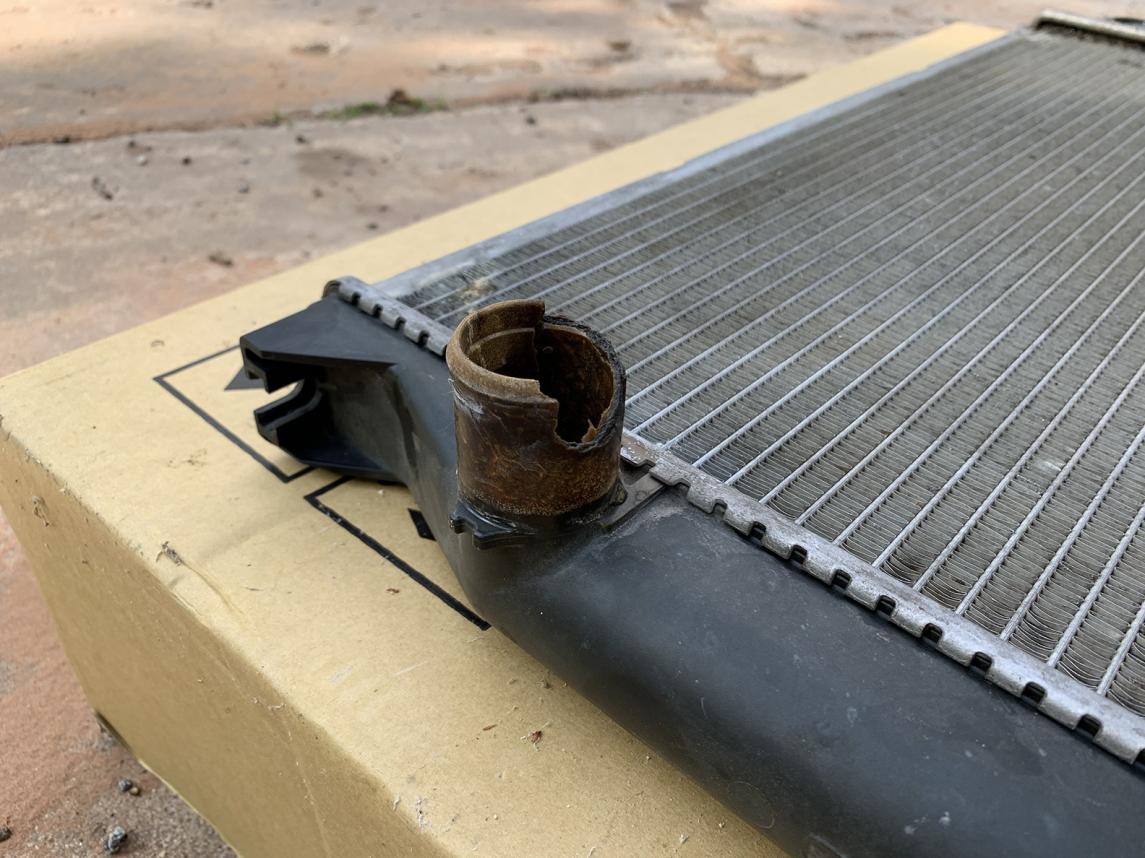

Sorry that your deal went down this way, and your story sure lit a fire under me. I was in the same scenario where I had stockpiled all the parts for both a radiator swap and a transmission drain/filter replace, but kept putting it off. I only drove the truck if it was absolutely necessary and towards the end even moving it around my property was starting to feel iffy.
Last night I just dove in and did both in one session, and sure am glad I did. Pulling the top radiator hose, the fitting on the old rad just crumbled. The rest of the plastic couldn't have been far behind for a 21 year old part.
