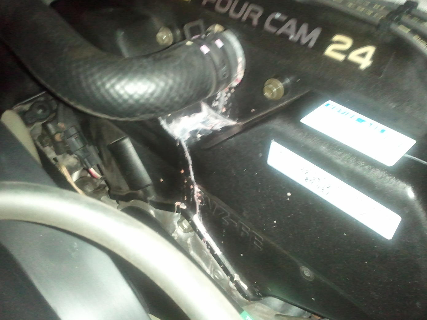

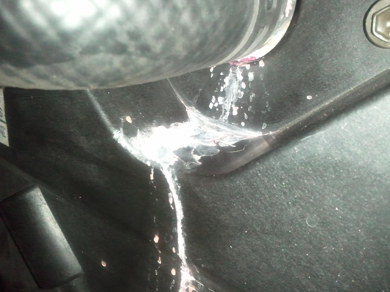

is this strawberry milkshake!?
i had my 90K service done at the dealer, and i looked under my hood today. please look at the attachment pics guys. help me out!

Radiator fluid? Come on guys. Coolant, damn it! And Toyota coolant is red. OP, you're fine. As other have said, if your coolant (not "radiator fluid") had mixed with your transmission fluid, you would know it.
