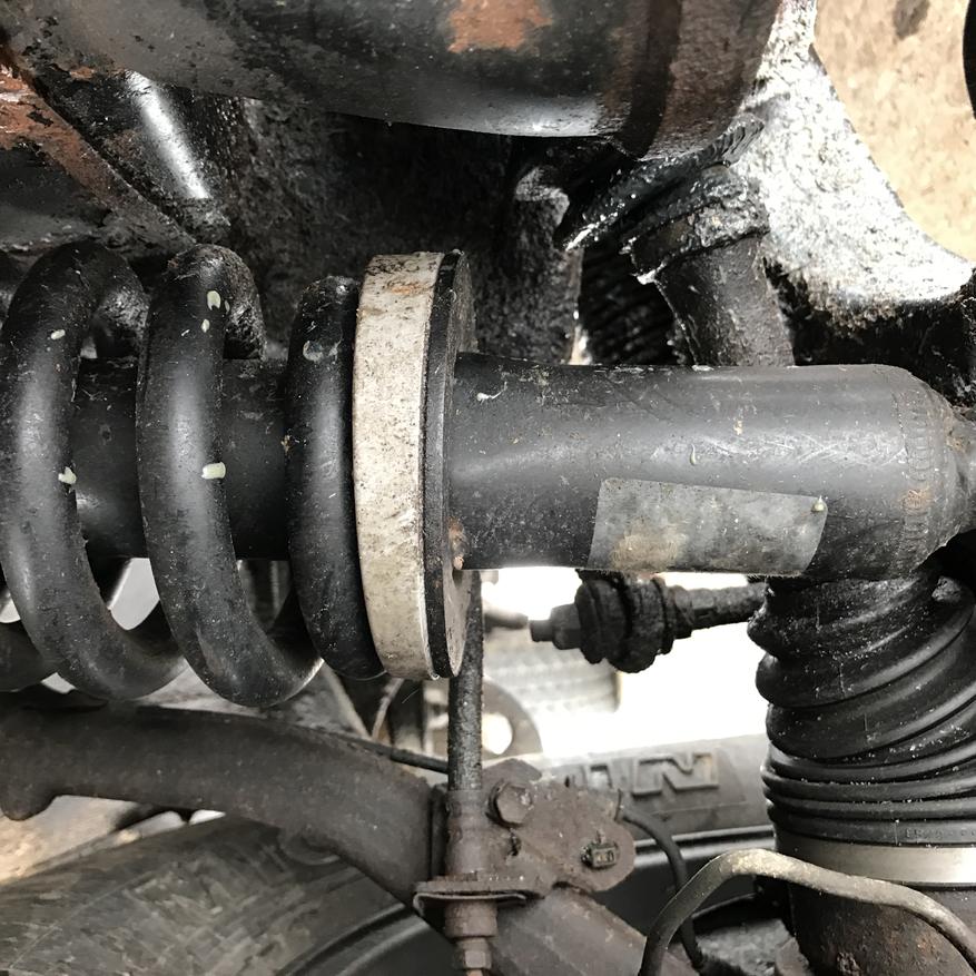

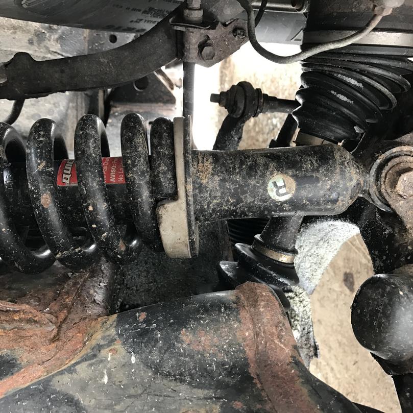

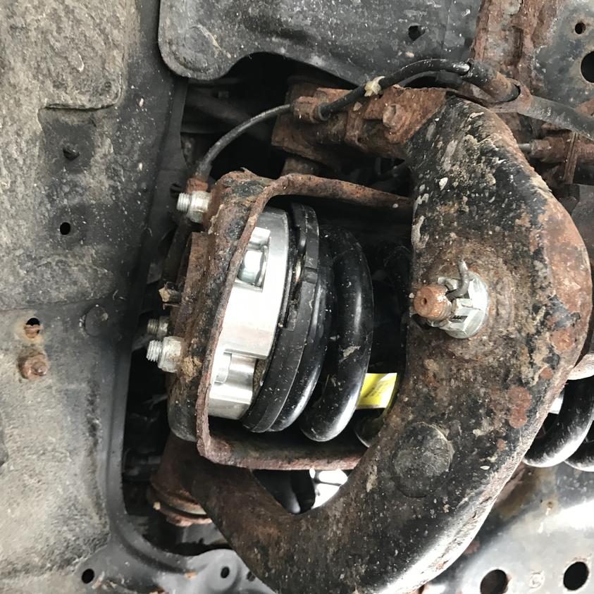

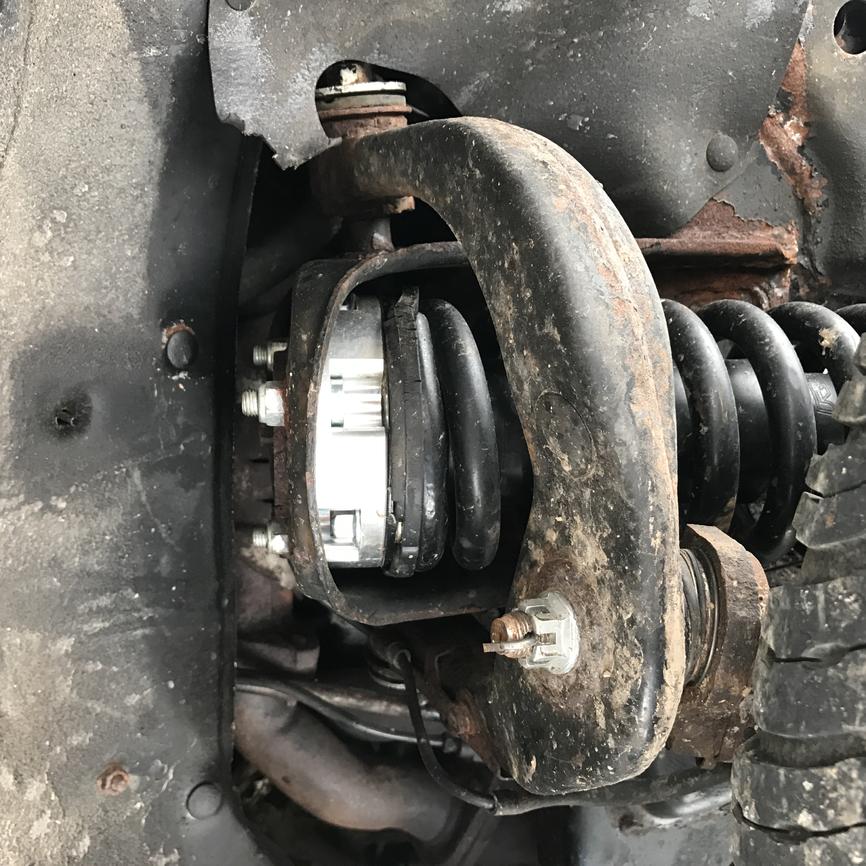

Here are some pics. The taco upper and lower ball joints are a direct fit replacement. They are just heavier duty. Lots of guys are running Taco upper and lower ball joints on thier TR4s.

Looks like Monroe Quick Struts = complete coil assemblies that include the spring = side specific.
The front shocks (yes, they are shocks, not struts) are not side specific, only the springs. It should be a quick swap L to R, though those top spacers might make it more difficult.
If you do Tacoma LBJ's, you need Tacoma outer tie rod ends too. As others have said, you lose some steering angle (which may or may not be bad, depending on your tire size).

you will have one coil longer than the other, this will be the driver side coil. I had an issue with fj coils someone sent me because the color combos were different but the longer is always driver.
I see , so it's the springs. How are these not struts? These are sold as "Monroe quick struts" ....what am I missing here?
Our front setup is pretty close to a strut but not quite. Struts usually hold the entire weight of the vehicle and have camber/caster adjustments. In our case they dont adjust any angles for alignment so its a coil and shock setup.
