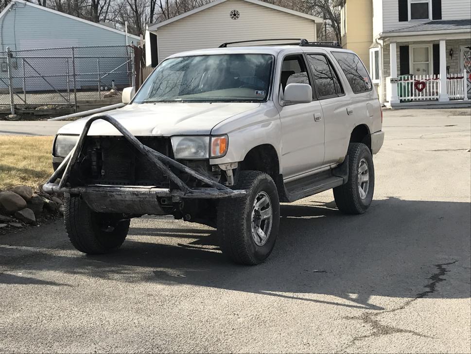

Ok, so I just changed these struts around right-wise in the freezing cold. Let me say that the ride is dramatically better. The geometry of these Monroe struts, and they ARE struts, is totally different from left to right. There are some retaining collars on the outside of the springs that are tapered away from the vehicle among other things. Took it in for an alignment and she rides like new. Note to self - don't be a pu$$y next time and do it yourself because NO ONE is going to pay attention to your truck like you do.
Alignment all done ready for pick up. I also have someone other than me change out the fuel filter that was rusted fast like a mofo for like 5 years after multiple attempts. When I started looking at my torch a little angel tapped me on the shoulder and said "don't be a retard"...and so that is also done and off my list.
