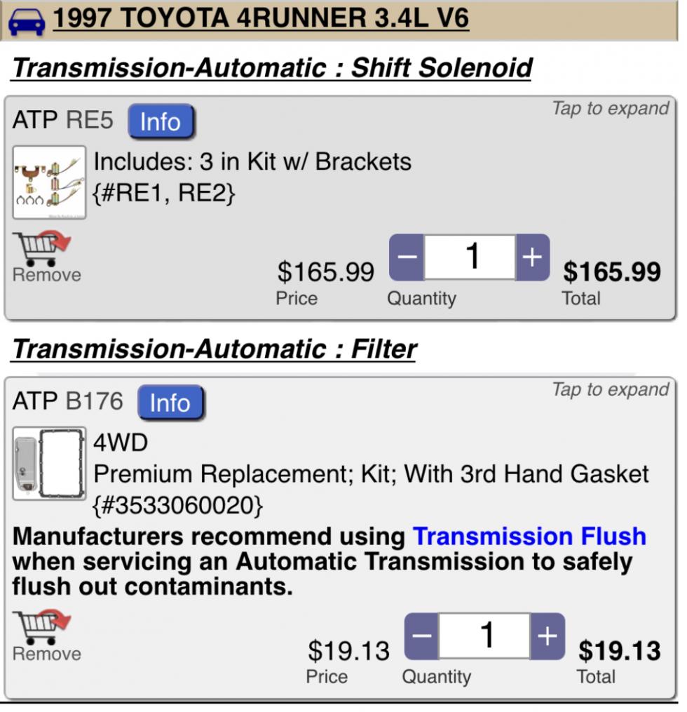

Called a new mechanic and he said he would do the job on replacing the solenoids and filter. Do these parts check out for a Solenoid Kit, Filter and Gasket?
Quick update:
Took it to the new mechanic and turns out that the solenoid that my previous mechanic installed was the wrong one and was smaller. New mechanic was pissed at my old mechanic. Once he replaced all the solenoids with the kit the code has gone away.
