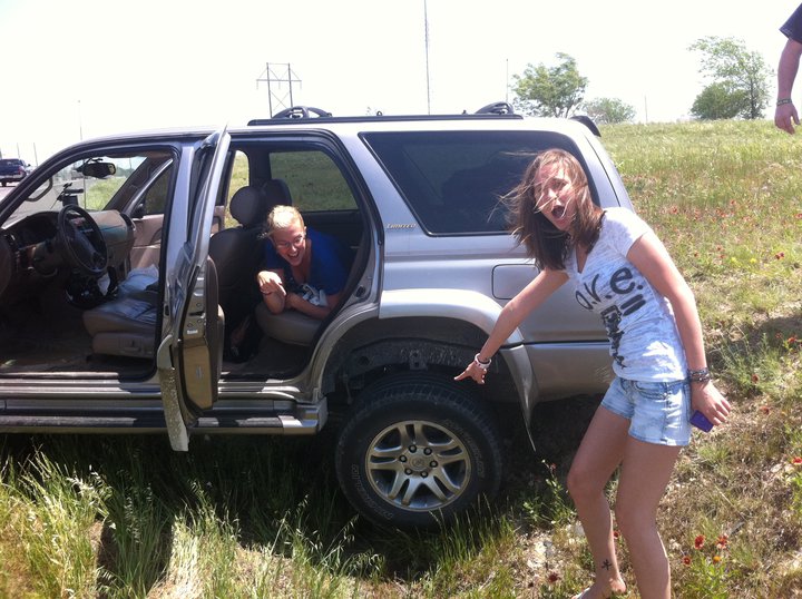

Do you have the center differential lock on that model? I had a similar experience last year. I was coming down a steep embankment that dipped, then came up to the road. Both of my front tires were flat on the ground/pavement, but my towing package got hung up, so my driver side rear tire, was off the ground. Even in 4 Low, the only tire that would spin was the tire off the ground. I was perplexed because I had never been in that type of situation before. I did a full walkaround while having a friend step on the gas to try and figure out what was broken. It finally hit me though. I hit the center diff lock button on the left side of my steering wheel while in neutral, and it pulled itself right off the embankment. Whoopsie!

Yes, but I had it in 4 wheel low. Both of my front wheels were flat on the road, and neither were pulling. The only wheel that had power was the one off the ground. I was just asking if he had the differential lock because that is what it took to get mine moving.
The OP's '97 has a part-time transfer case. Unlike your '02, it has no differential in the transfer case.
When you shift a '97 into 4wd, the front and rear driveshafts turn at the same speed. It is essentially same as when you lock your transfer case differential.
Gotcha! I wasn't sure about the earlier years. I was only comparing my experience to his. Thanks for the clarification.
