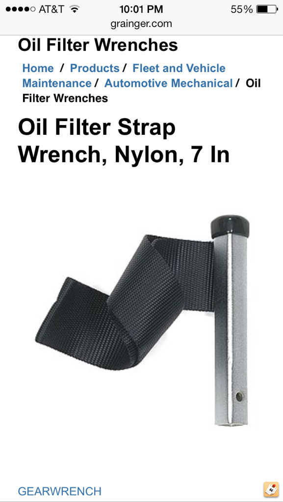

I use a filter strap wrench. Owned it for at least 20 years now. Worked on everything but the trans filter on my brothers satty.
Driving a long thick screwdriver didn't do it. But the screwdriver AND the strap wrench did.

Yeah I'm going to pick one of these up.
I use the oil filter strap wrench on tough filters as well, the bar dents in, and then it really grabs well.
Just be sure you get one that fits the filter you want to remove and that it also fits the one you want to install (or get two). They are not all the same even for filters that work on the same engine. For example, the Toyota filters and the NAPA/Wix filters for the 3.4 V6 use a different size cup wrench.
