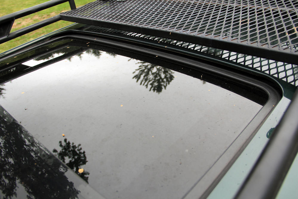

Just had a recent offroad trip and the sunroof wouldn't open. I could hear the switch making contact so I knew I had power. It stopped working when the back end tilted down.
Anyway, I did a search on here to see what the likely fixes were and came across a thread where someone removed the entire switch, map light, glass holder assembly to access the motor and tapped it with a hammer.
I can't seem to find that thread again but I wanted to give the guy some kudos as that's exactly what fixed mine. I used a small ball-peen hammer and tapped it a few times. If anyone stumbles across that thread, link my thread to it. Thanks!
I think I'm going to leave it closed for a while!

Having a sunroof and not being able to use it sucks so bad
I agree, mine has never worked, one of the buttons make the motor move for just a second, but the glass never moves. The other button does nothing. I need to take my roof rack off and take it all apart. Now I have the issue of it raising up when wind catches it.

This has happened to me as well. Tapping the motor unfreezes the motor brushes from the armature, but I wouldn't consider it a fix. It hasn't happened to me again but the proper fix would be a new motor. But until it happens again, I'll probably keep smacking it to work!
