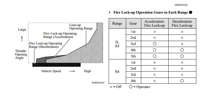

I’m wondering if this is the “flex-lock" that you’re noticing. This is assuming that you are in “D” and not in “S Mode” So for instance try the same thing (around 30-40 mph) in S-4 and see if you still feel it “stumble or hesitate some”. Hope this helps.
Visual representation of the above.

What [MENTION=112949]Laurich[/MENTION] said. Drive around in S4, bet it goes away. I never drive in D in town, I've had that oddity since new.
+1 For Sprint Booster
