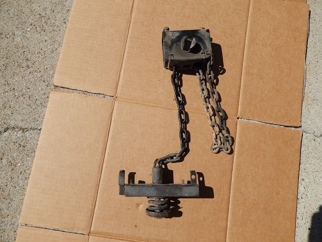

How does this thing operate? I cant seem to get the chain slack length to change

You would put the bar into that slotted gear in the middle and crank it to move the chain/tire holder up or down.
Is there any way to lube this thing? I used it last a year ago, but when I tried to lower the tire last month it took about 10 minutes to get it to break free. Any suggestions to keep it from rusting solid over the winter?
PB Blaster.
If that doesn't work, google/search forums for a concoction of something like brake fluid, transmission fluid and acetone.
quitter^^^. ok, not really.

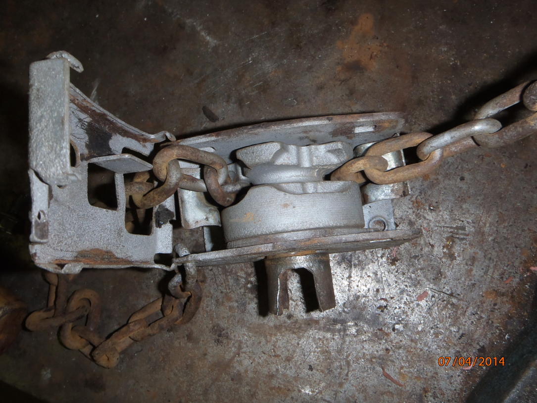

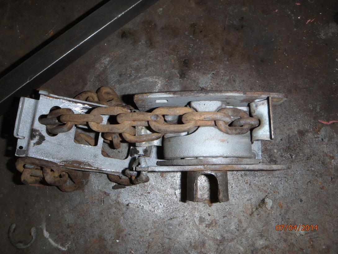

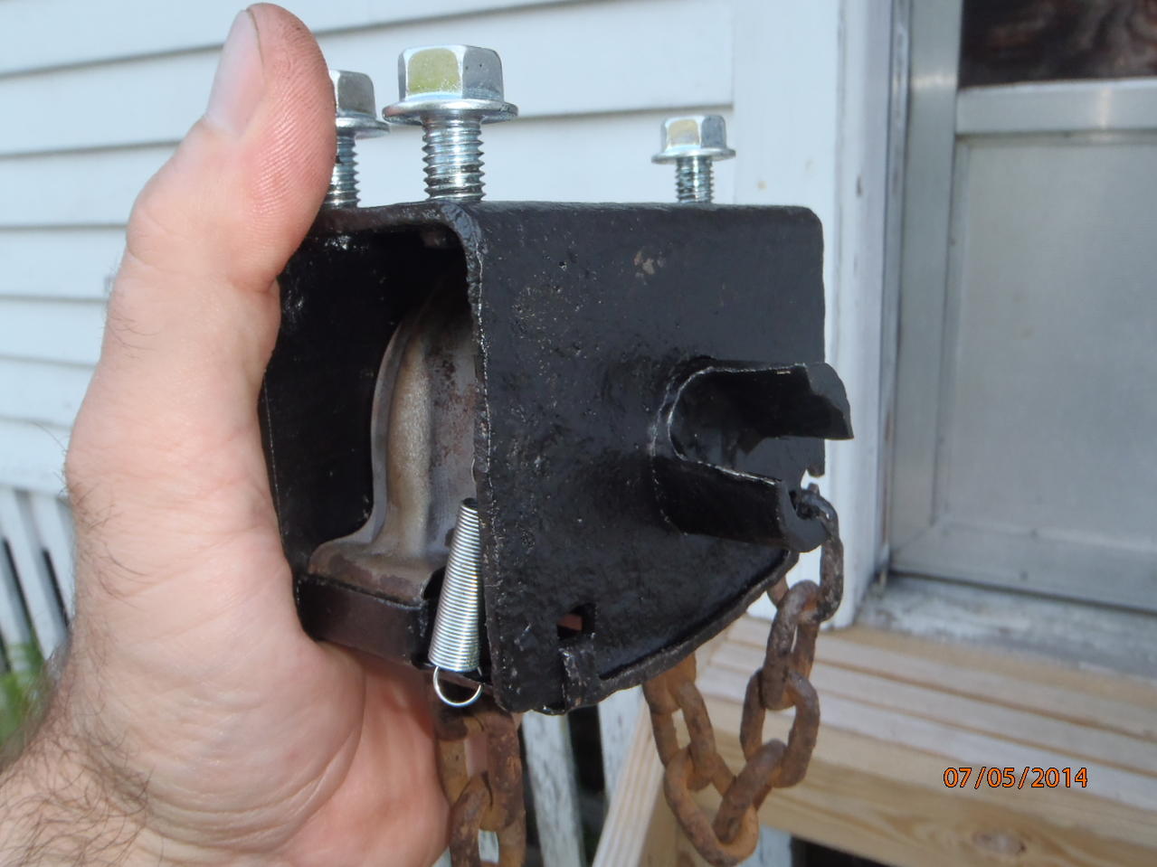

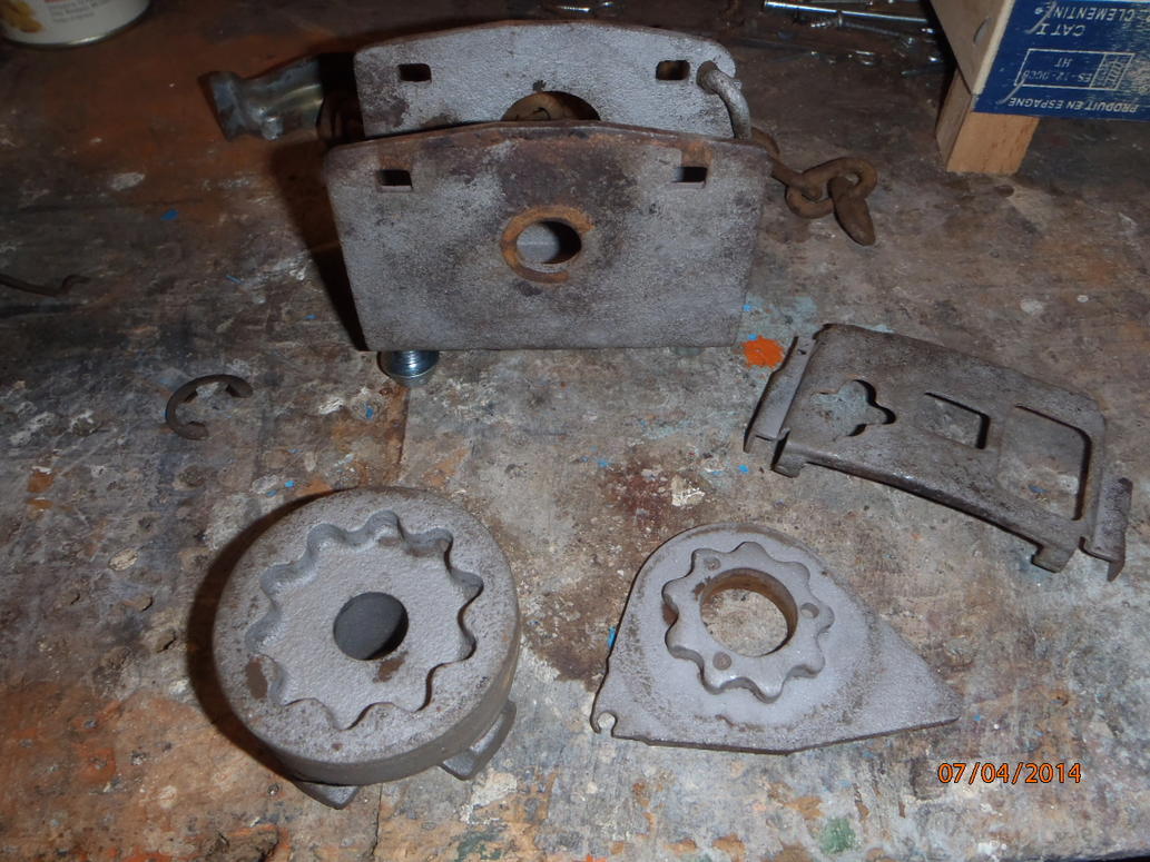

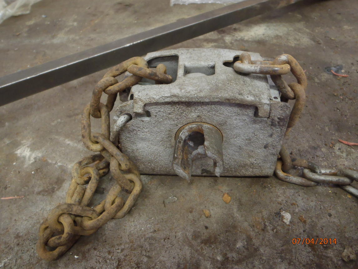

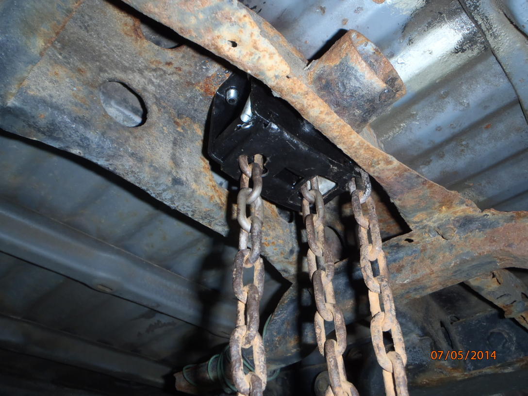

i don't know how successful just spraying lube in there is going to be. like you, i removed mine from the runner. but i took it apart, sandblasted the rust/crud/dirt/gunk off, and then painted all the parts. i reassembled several times to verify operation, and eventually lubed the assembly with chassis grease and did final assembly and installation.
you'll need to gently pry open the tabs on the cover to open it up (the piece with the cross, through which the chain passes), and then take everthing apart and give it a thorough cleaning. the tiny spring that attaches between the slotted cover of the assembly to one of the gear pieces may be missing or broken, which might also explain why yours doesn't work.
i've got a bunch of photos of the assembly and the innards. i thought i put them in my "maintenance" thread, but i'll have to check.

Thanks Wallytoo. Mine's a '95 so it uses a cable instead of a chain but basically its the same principal. I'll have to try that.
That was extremely helpful. Perfect example of why I love this forum. I assume these things just lock up after extended periods of no use? Anyway if that doesn't work, then it's up to Yoda Jim's, my new favorite place.
Come to think of it mine's not quite that simple, there are some shafts and u-joints in-between where the crank inserts and the housing for the cable reel. More joints to lock up so I'll just have to see how much of it I can get apart. I'm having some powder coating done on some other parts so maybe I can get these blasted at the same time.
