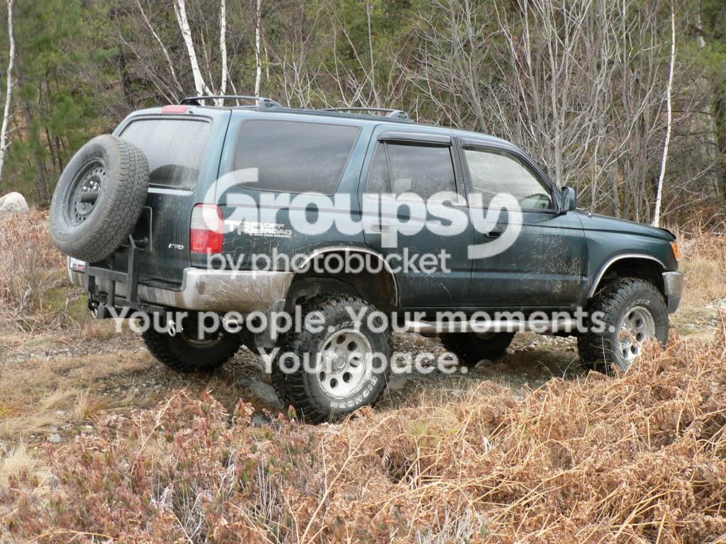

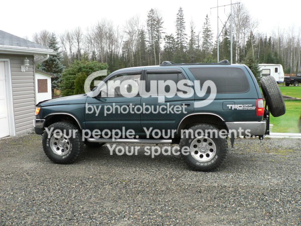

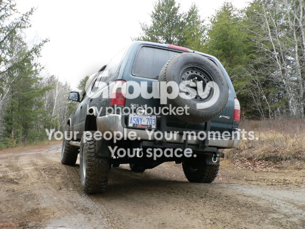

Here's some pics for reference:
P1110313.jpg~original
P1110360.jpg~original
P1110363.jpg~original

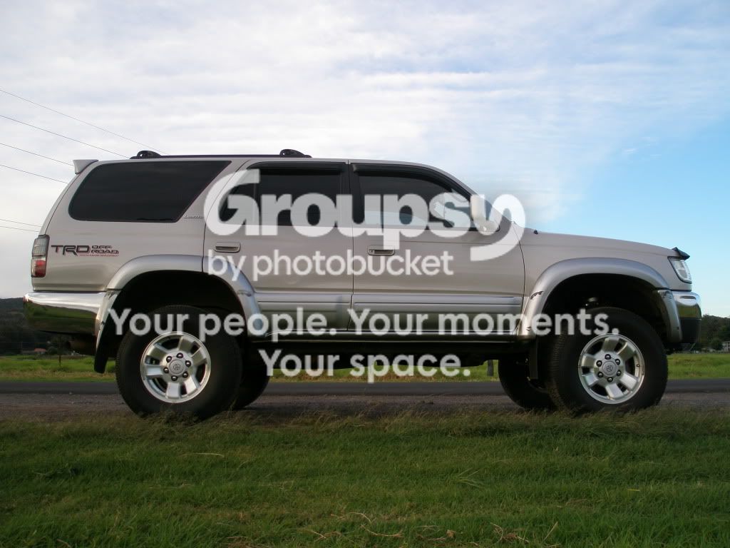

With the body lines, and the roofline of the 3rd gen 4Runner being the way they are, a little rake actually makes it look level.
If the wheel well gap is identical front and rear, so that there is "no" rake, the rear end of the truck still looks lower because of the roofline.
However, if the rear wheel gap is .5-1" greater than the front, the roofline looks level. Anymore than that, and the roofline looks obviously raked.
1" more wheel gap in rear:
_DSC2148.jpg~original
Even wheel gap:
feb21003.jpg~original
I agree ^
