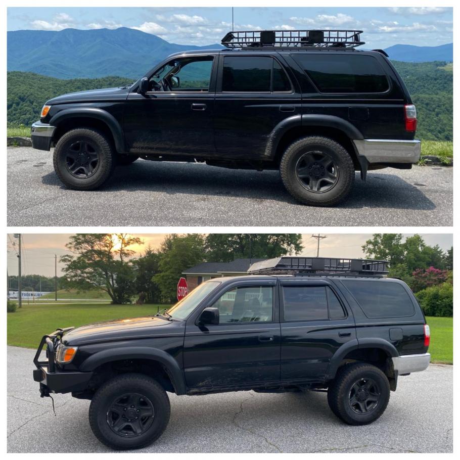

I wanted to share my latest success install new shocks and springs to my 2002 4runner. This setup was intended for heavy loads on both the front and the back. With this setup, I gained about 4 in of clearance (saggy old shocks and springs), but with some time and the shocks and springs are settled, it should yield around 3 in of clearance. So far it rides really smooth, much better than the OEM suspension that has most likely been.

  • Currently the pictures are showing 31 in tires
  • The back is about 0.5 in higher than the front
