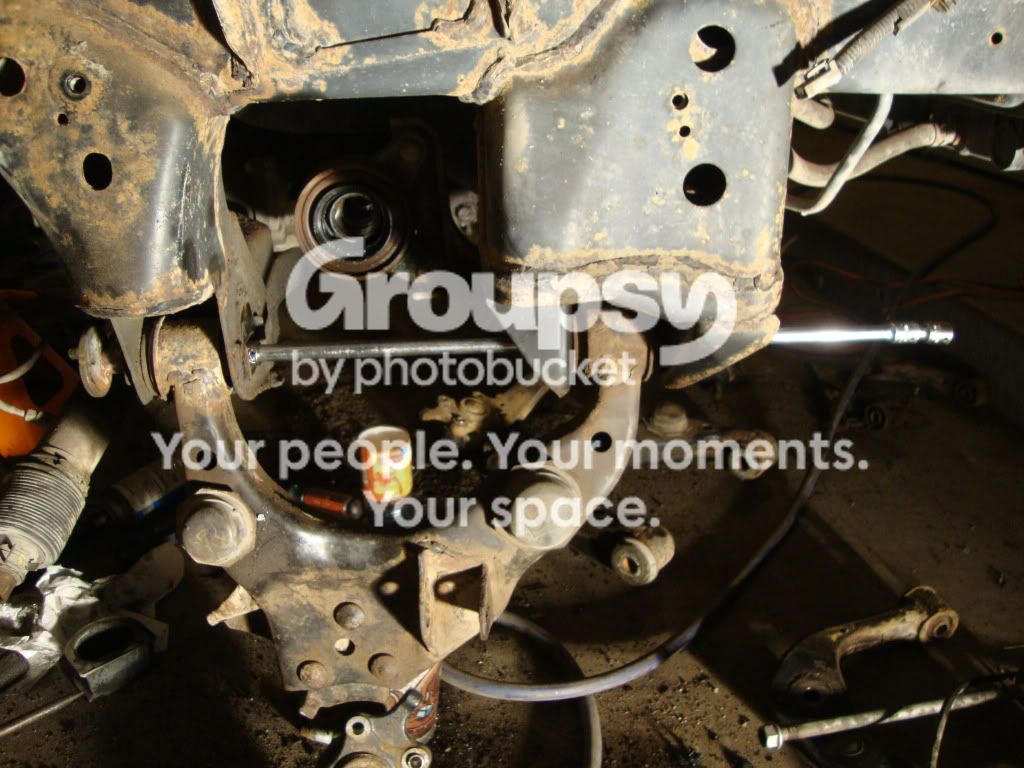

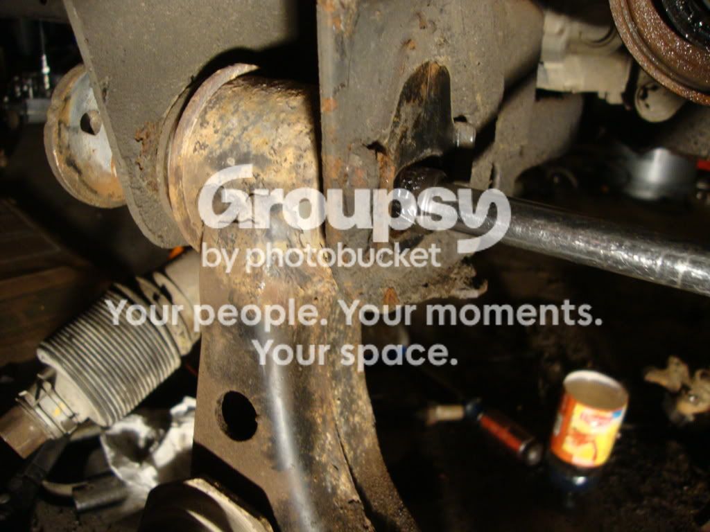

I used an air hammer and chiseled mine out. A 3/8" ratchet extension fits thru it and 1/2" socket shoulders on it and I put the air chisel to it and they worked right out for me.

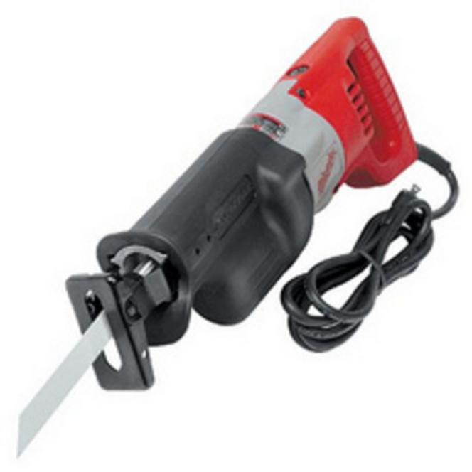

I love PB Blast. When my LCA cams were frozen, I gave my sawzall blade a light coating of pb blast and it powered right through the bolts. (the saw just worked it in there really well I think....:shrug:)
