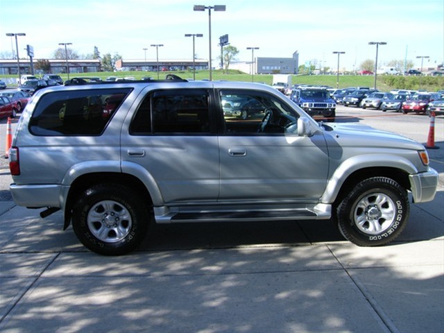

Hello all. I know there are alot of threads on lift kits here. I am only interested in 2.5" front and either 2 or 2.5" rear. My question is; Are the Bilstein 5100 adjustables and stock front coils a good combo? I have already decided on OME springs for the rear. I am on a tight budget having just bought this 2001 SR5. I talked to Wheelers off road earlier today and was told that the 5100s would adjust up to 2.5" of lift with the stock front coils. I would rather have input from those on the site rather than a salesman possibly telling me only what I want to hear.I was quoted $475 shipped for the following: Bilstein 5100s , OME 2 or 2.5" rear coils with Rough Country shocks and the 1" diff drop. What do you think? Also, I don't hardcore 4wheel just camping and hunting off the beaten path.
