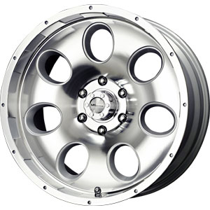

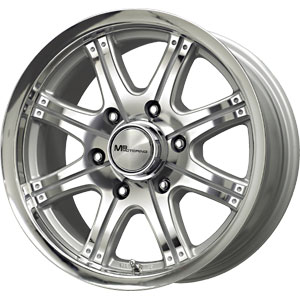

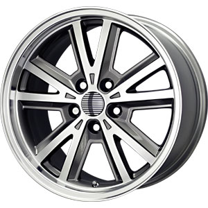

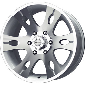

How about these? Comments? All are "MB Wheels" or "Replica Alloys" from Discount Tire.
I like the first or third one for the stock look. BUT for the off-road look, I like the last one they look like Mickey Thompsons with a bead lock :)
I like the last one as well.... How much are those?

These ranged in price from $90 to $116 each. You can see them at discounttire.com
I thought the prices were reasonable.
Now those I like! At first I thought it was $789 each, but it looks like that is for a set of 4. That price is not too bad. Do those have the 4.5
