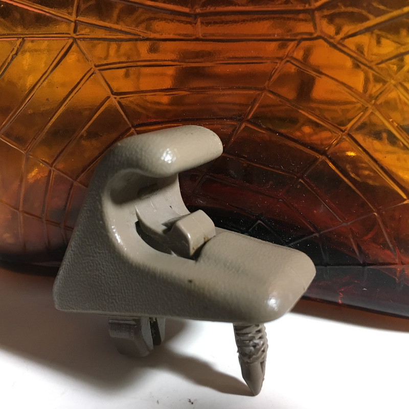

There is supposed to be a spring loaded retainer tab inside the retainer that holds it in. It's broken off on my driver's side and intact on my passenger side. If you didn't know it was supposed to be there you'd be hard pressed to figure it out.
Don’t ask why I have a pic of this on my phone...
Swing by any junkyard with a 3rd gen and grab one. Nobody but weirdos like me ever grabs them. This is how I cover the $2 door charge — if I don’t find whatever else I’m looking for on that trip.
Never know when you might need these sort of things...
Mine must be broken off...I had no idea. Is there a part number on the back of that thing?
The part number is going to be different for each interior color. Unlike some contemporary (or even current) domestics, Toyota made sure most of that stuff color-matched. You can look it up online from the various Toyota dealers selling parts over the internet. It's reference number (*not* part number) 74348 in the below diagram:
