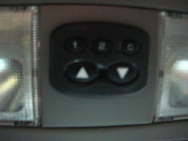

Does your Moonroof panel look like this one in my 03 4Runner? I have the same issue on my truck...
Please note that I had this happen after a battery change on my '05-4Runner and NEVER could get it back in to place after trying all procedures. Finally took it to dealer and they fixed it (very expensive) and they checked with Toyota and Toyota refused to pay for the repairs even though I had the Platinum warranty. That was a bummer.
