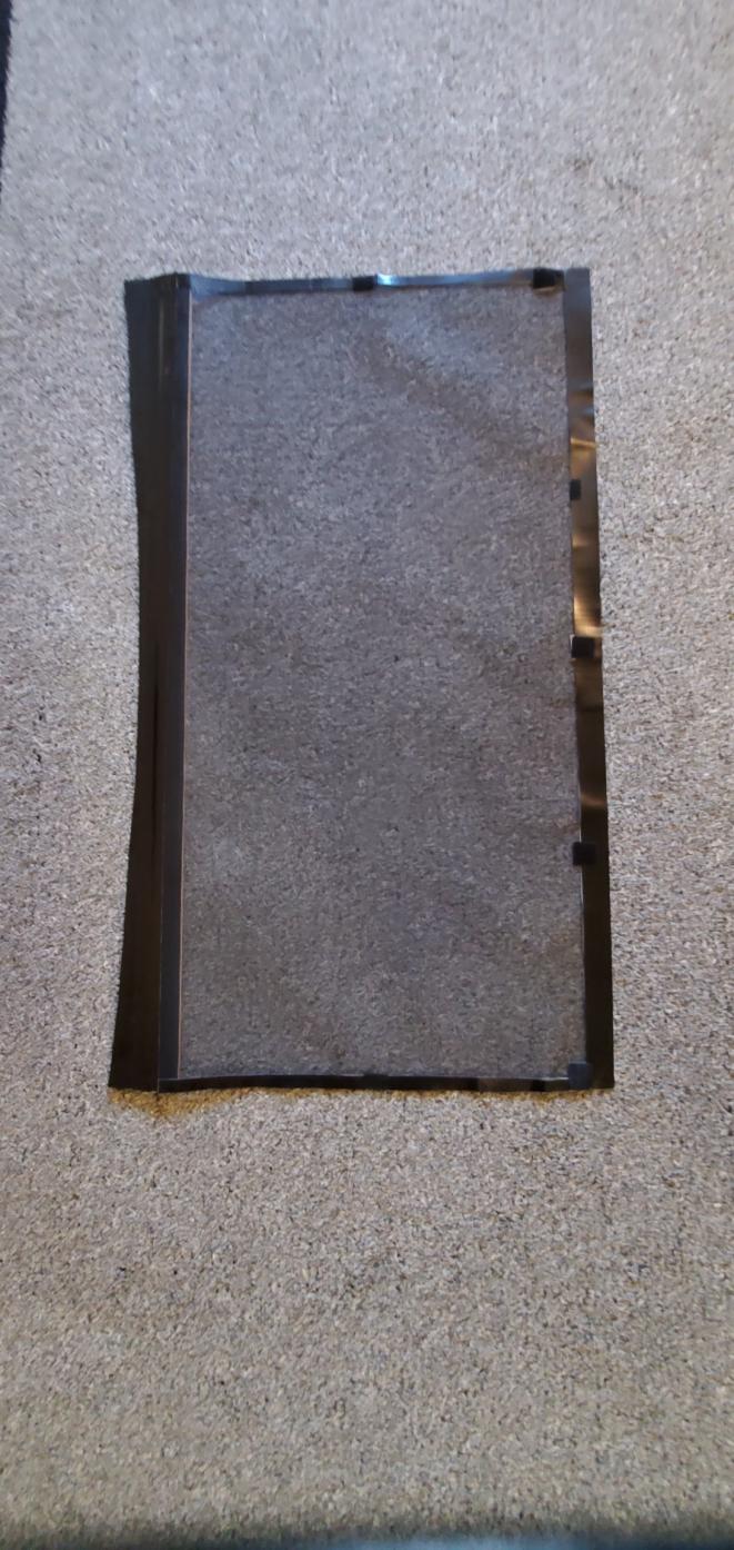

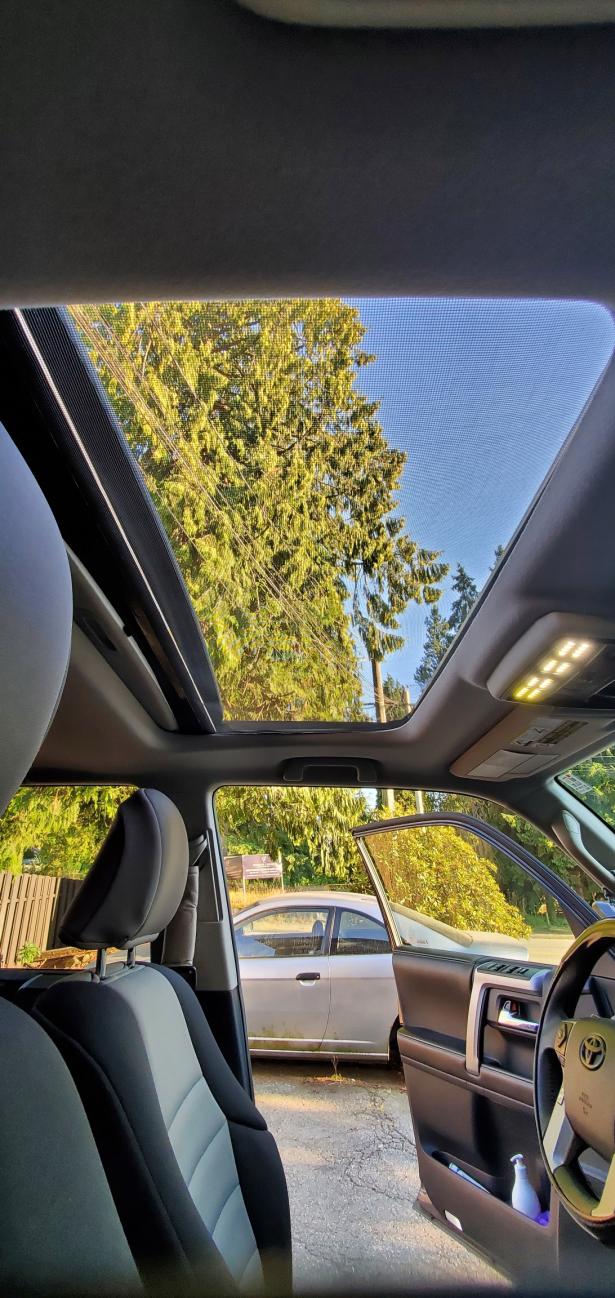

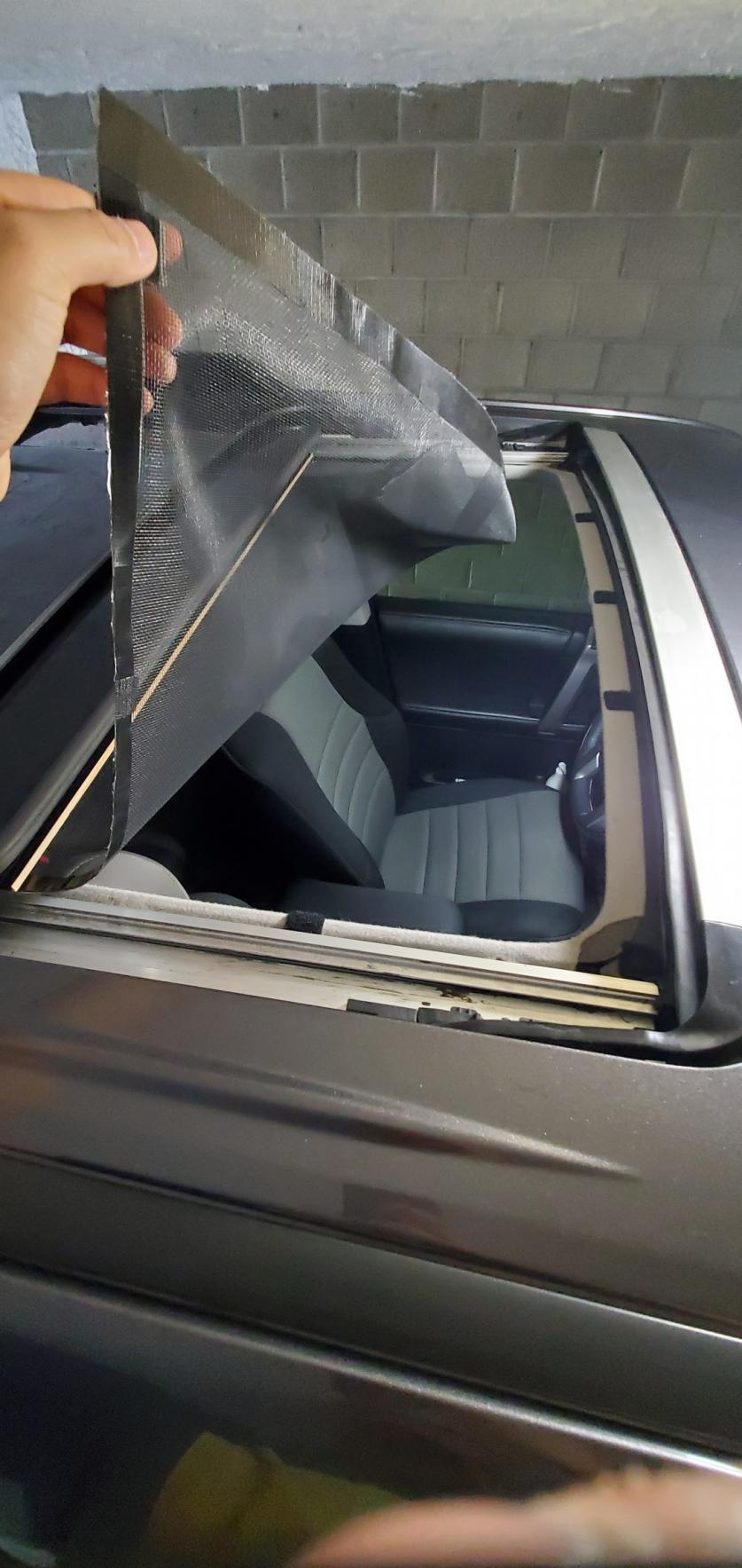

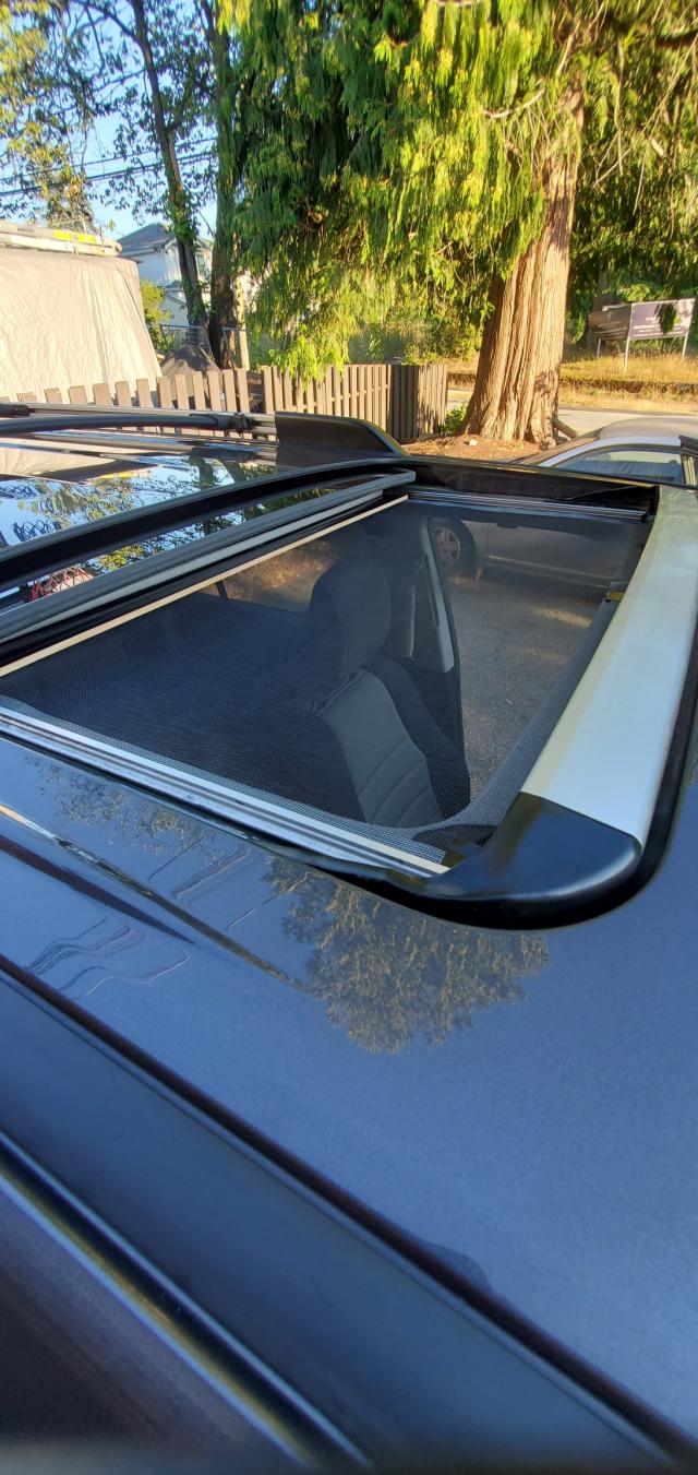

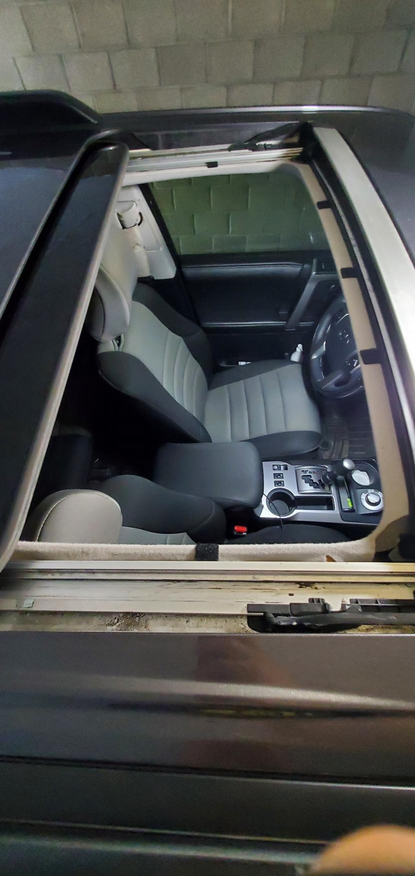

Made a bug screen today. You can still open and close the sunroof. But to use the sunshade it needs to be removed. Used a wooden ruler and a plastic sheet taped together to make the "base" so the mesh has a firm piece to attach to and prevents sagging. As you can see it is slightly curved. Black duct tape around the edges. You can see the black squares around the opening - those are just velcro patches. Pretty simple once you get your measurements.
