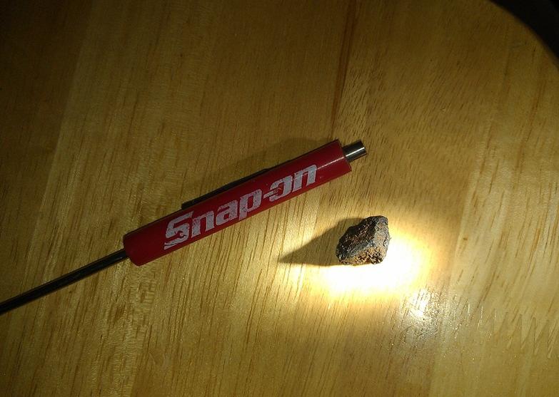

well i found out what it was, after getting a little mirror and looking around in there i found a rock that had some how managed to get into the track between the front and rear legs of the glass, and would not let the sunroof come down all the way, and subsequently when the sunroof did drop it would come down ontop of the rock and bind up not allowing the sunroof to travel... all is good now everything works. i still have no freakin idea how that rock got in there... maybe from wheeling, but i dont go wheeling with my sunroof open so i doubt that.
this is the rock, damn little bas****
