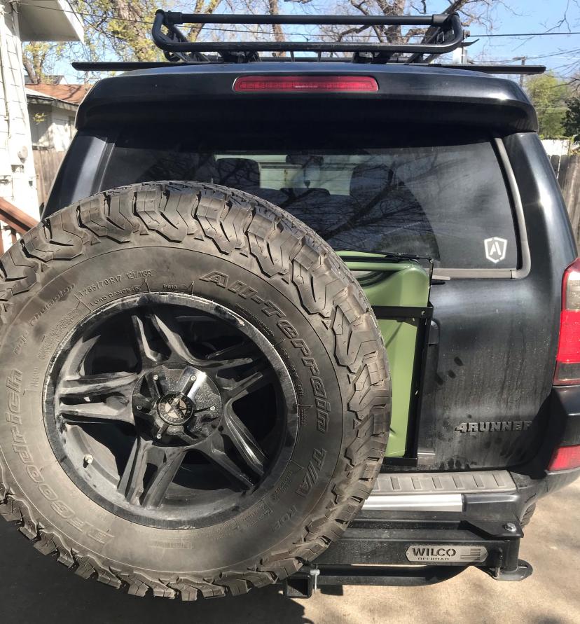

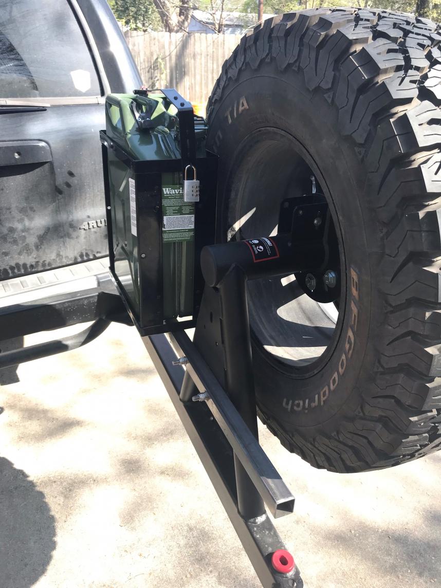

Wavian gas can and gas can holder, 1.5" square tubing from HD, step drill bit, a smidge of hacksawing, and some 3/8" bolts with locking washers and nylon nuts.Not including gas can, about ~$100 including gas can holder. WO wanted ~$300 for their setup. I'll pull it and paint it next week.
