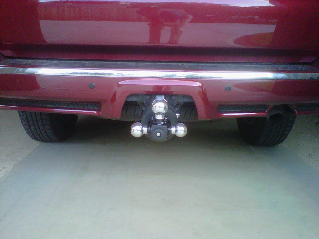

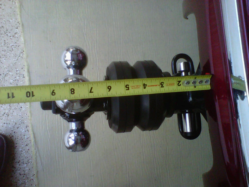

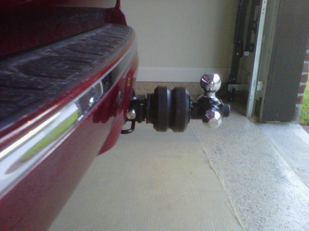

I got off my butt and finally installed the bumper. It took less than 1 minute to "install". The unit was very heavy...17 lbs heavy. It was heavier than the near full sized superbumper that I got for my wife's Pilot. Very impressed with construction and the gauge of steel used. I had the Superbumper turned up (per the picture) but it was setting off the rear sensors. I talked to John (owner, Superbumper) and he suggested that I turn the unit upside down. I did and it hasn't been a huge issue. The sensor still goes off every once in a while. I consider this a minor price to pay in case of an accident. The unit sticks out approximately 10"; I can still get in and out of tight underground downtown parking without any issue. John also kicked in the locking pin for free.

So wait, you put this on only so impacts are directly passed onto the frame of your vehicle, rather than the absorption zone on your bumper?
Not to questioning your logic or anything, but this defeats the purpose of a shock-absorbing bumper, frame and body crumple zones, and instead puts all the force of a rear impact on a single frame rail.

Superbumper does the opposite: it absorbs energy and reduces whiplash. It uses rubber buffers to absorb energy. Also superbumper is not dead locked in a hitch, it can travel forward for couple inches so it doesn't affect a vehicle frame.

Wow, just wow. You have several inches of the impact directly transferred to only the rearmost frame crossmember. That will exert lateral force inwards on the frame ends as it gives way, and will likely jam the rear bumper shock absorbers. Until then the frame transfers the energy to the body through the frame mounts.
In a collision, the energy transfer over time is changed substantially by the addition of this, and the extra length lengthens the time further. This can, in fact, change accelerometer readings which then cause other side effects like airbags not deploying, or worse yet, that wonderful piece of engineering, the active head restraint from getting enough leverage to be in place in time to stop your head snapping back.
