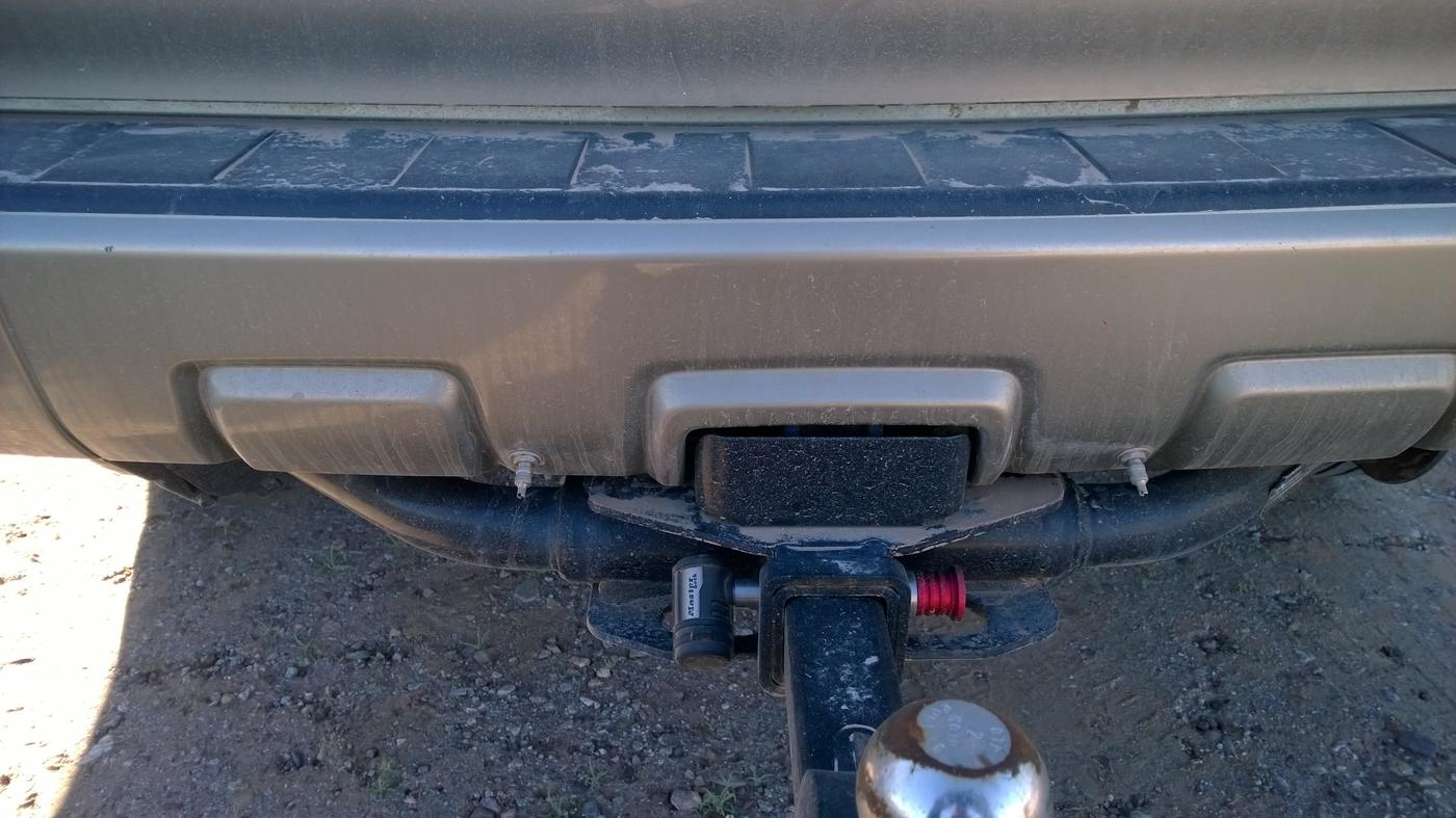

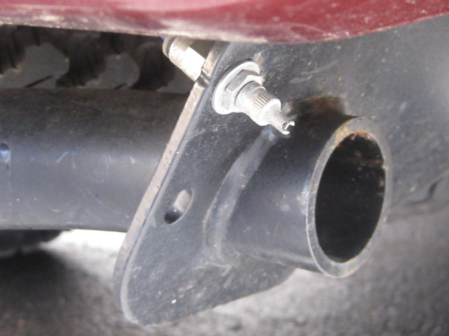

Here is my fill location. Excellent location for filling but exposed to the elements more than i thought and am getting some rust on the hex nuts. Going to have to get stainless replacements or paint them.
ran air line thru frame & mounted valve on the hitch itself.

Rear bumper cover. I put wire loom around the air lines for the runs. Also got 9" airbags from Firestone for the additional coil length, I believe stock are 7". I have the Toytec Superflex RCC2.0 coils. Got a nice lift from them to keep the hitch from dragging offroad.
