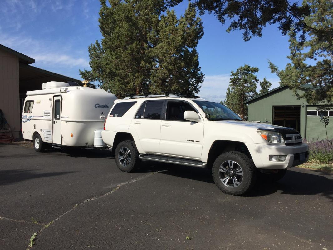

I agree with Mike. Prior to lifting my 03 limited V8 I added the airlift 1000’s Same as the link provided. I could air them down for a comfortable ride, and then air them up just a bit to level things out when I was towing my Casita RV.

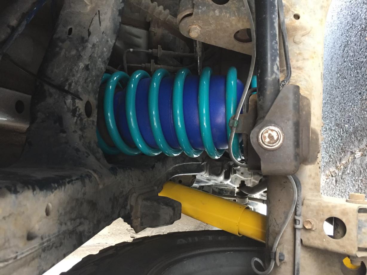

Things to know. You have to cut down the original bump stop, and I had to enlarge a hole in the center or the spring seat for the air line to run through comfortably. I’ve run this setup for probably 12 years. A couple years ago I switched to Firestone air bags as there was a longer version I needed when I added a Dobinsons lift and had a longer spring in the back. Image is of the Firestone bag.

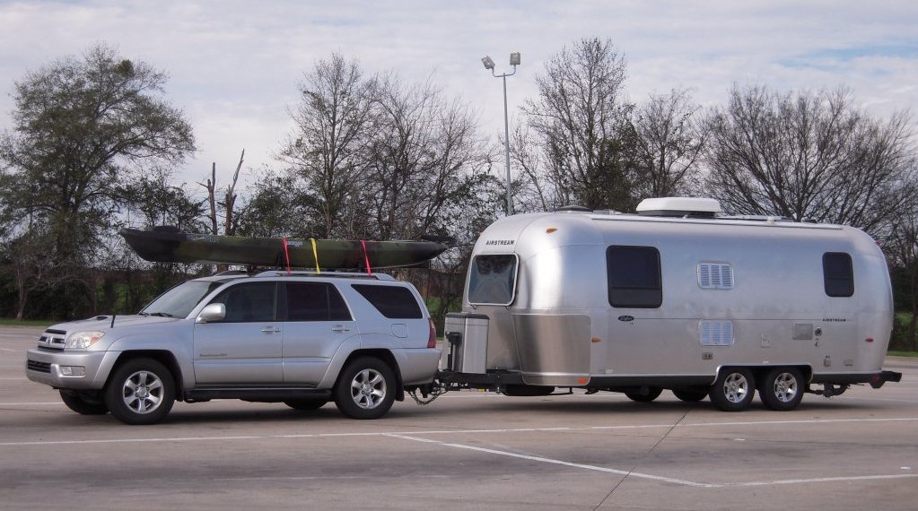

I have a Sports Edition also. The X-REAS shocks were standard on the SE. I've never had a problem with mine and the T4R tows the Airstream very well. Cornering, turns, lane changes, high winds, it takes it all in stride. I purposely bought the SE because of the X-REAS for their handling capability. If they aren't leaking then they should be fine.
