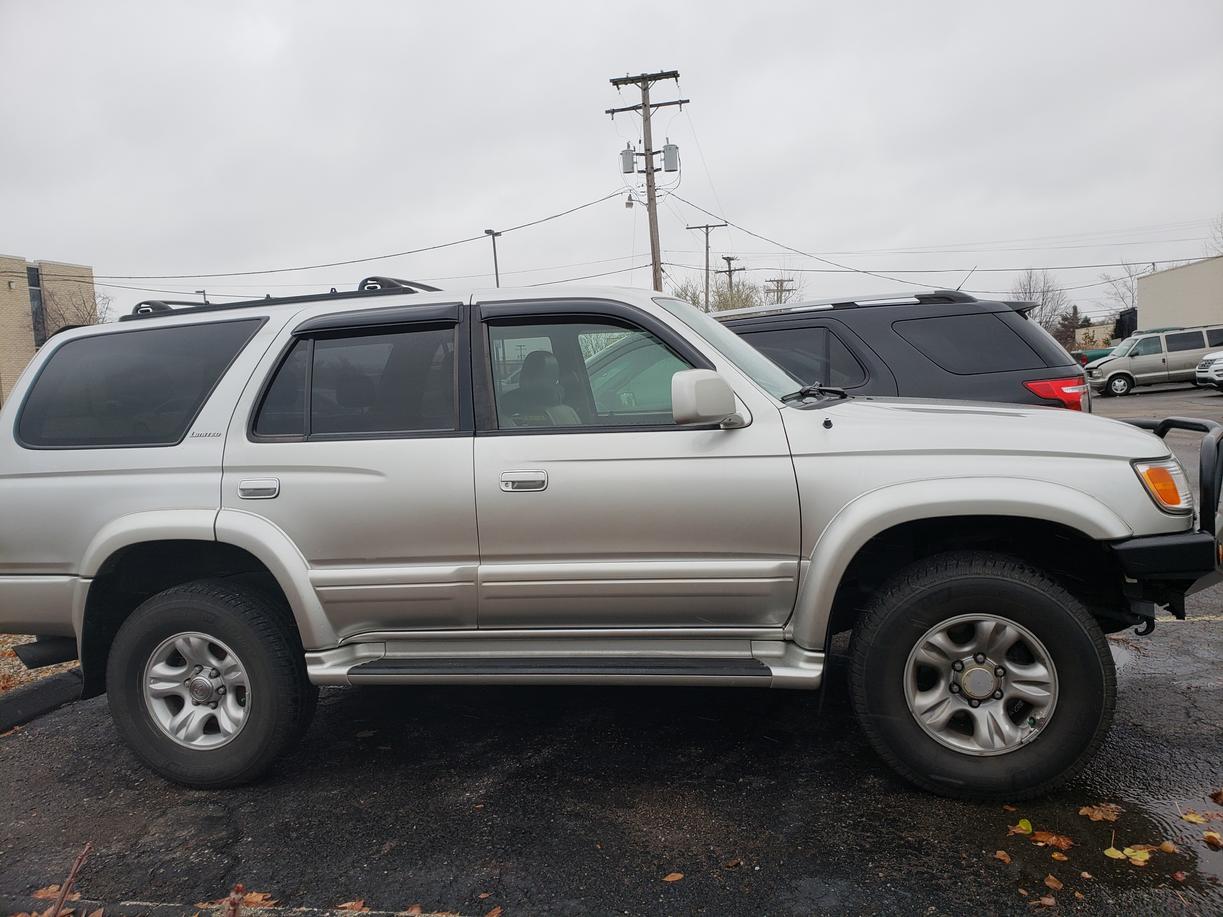

Here's a pic of my truck.
I forgot to add that I'm actually adding a stainless steel skid plate (10ga) from SRQ Fabrications which is currently in the trunk. I think that's around 50lbs that's going in the front.
Based on the pic and my measurements, will I even need a new suspension?
That's totally up to you! Your front is still above the standard stock height of most 3rd gens, for reference.
That 100lbs you added to the front is about 5% extra weight on the front - not a huge amount (~3900-4000lbs stock weight, slightly more than half on the front).

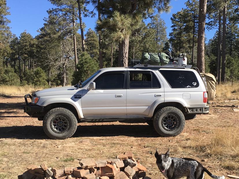

The coils are 600 lb. I have Schrockworks front bumper but also have additional weight of full skid plates and rock sliders. The 6112 are adjustable so measurements would depend on what it is set at. Here is a picture of my set-up fully loaded. And for reference, I only wanted a 2 inch lift.

I previously had Tundra (5 perch) bilstein 5100s and OME 881s on my '96 with a CBI hybrid front (at least 100lbs)
With that setup, 881s on the second perch, i was sitting at ~22" hub to fender.
It handled fairly well...not too much diving with braking and corners.
FYI 881s are roughly a 500lb coil. 883s are roughly a 600lb coil.
I switched to the 883s because i went a bit higher without preloading the 881s even more. 883s on the second perch, im sitting at ~24" hub to fender.
