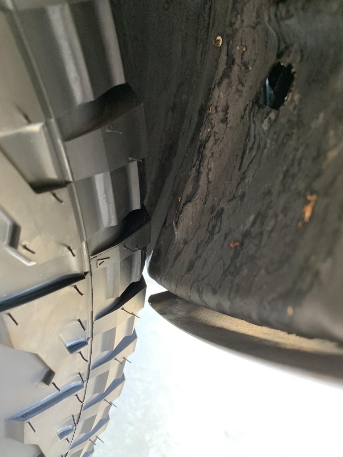

That's probably a good idea. I was a bit worried that the 5100s would struggle without the additional support from the coils, but I'm not adding a whole lot of weight so it might be better to wait and see how it holds up.
As for the rubbing, I did some testing today and found that I'm actually rubbing on the front fender, not the flaps. It only happens when fully cranked in either direction and reversing. Also, I'm running TRD Pro wheels, so my offset is a bit different than stock. Gonna have to dig in to find the least intrusive way to address it.

Angle grinder and trim down the bumper a millimeter or 2 and move the fender well forward a bit.
There are 2 screws holding the fender liner at the bottom
Remove them slide fender well foward a few millimeters and screw back into place.
It is very easy to trim the front fender and move the liner back a bit. This will solve the rubbing issue.

I found I didn't need to trim anything, moving the fender liner forward solved the rubbing issues. Thanks for the advice!
