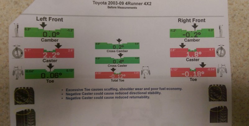

Did you get an alignment afterwards?
The issue may not be with the shocks themselves, but rather with lifting the front end. You effectively change the geometry of the suspension. In doing so, you lose some caster in the process. If you did not get an alignment after installing the 5100s, you may even have some slight positive camber.
Good point. We did not get an alignment at the time so I'll definitely look into that. Thanks for the input.
No problem. Go get an alignment, I can almost guarantee that will solve your problems.

Got the alignment today and $95 later, I can't explain the improvement. It's the wife's so I'm going to let her take it out today and let her make a decision on her own without my opinion but I'm sure she's going to be more than pleased.
It was most definitely out of alignment. :lookout:
