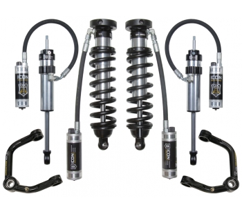

I'm.looking at the Icon Stage 5 Suspension Lift Systems. It will give me a 3" lift. However am I going to have to set my vehicle up for long travel? Has anyone put this lift on how do you like it? What suggestions can you make? Will my OEM Lower Control Arms be compatible? I am thinking of doing a piggyback system on the front what do y'all think? Any suggestions are greatly appreciated. Even if it's a completely different set up.
1996-2002 Toyota 4Runner 0-3" Suspension System - Stage 5
1996-2002-toyota-4runner-0-3-suspension-system-stage5.jpg​
  • Price: $3,963.33
  • SKU : K53135
  • Brand: ICON Vehicle Dynamics
  • Weight: 105.00 lb

KEY FEATURES:
  • Increased wheel travel and ride quality over stock
  • Decreased body roll
  • Vehicle-specific tuned front and rear shocks provide superior damping and control
  • CDCV technology allows for quick and easy compression damping adjustment
  • Coilovers are adjustable from 0-3" of lift height
  • Shocks are fully rebuildable and revalveable
  • Corrosion resistant CAD plated coilover shock body with 7/8" shaft
  • FK Rod End bearings for extended longevity and minimal deflection
  • CNC machined 6061 aircraft-grade aluminum components
  • Tubular steel upper control arm features 1” PTFE-lined stainless uniballs and greasable bushings
  • Bolt-on design makes for straightforward install
  • Made in the USA

SYSTEM COMPONENTS:
  • 58716C (QTY.1) | 1996-2002 4Runner Front 2.5 VS Series Extended Travel Remote Reservoir Coilover Kit w/CDCV
  • 57800CP (QTY.1) | 1996-2002 4Runner Rear 2.5 VS Series Remote Reservoir Shock Kit w/CDCV
  • 58400 (QTY.1) | 1996-2004 Tacoma / 1996-2002 4Runner Tubular Steel UCA Kit

That's a TON of money for suspension, my friend. Maybe you have $4k to blow idk but you can get a really good set up for $1,000-$1,300 and have room for added extras
TBH I am new to the 4Runner game so I wouldn't take suggestions from me but I will show you my order sheet. I have no experience with it yet because I am still waiting to install it but I figure, after my hours of research, it'll be enjoyable.
IMO the SS 1.2 looks to be pretty awesome and even comes with the extended bump stops, I think the extended brake lines and idr but maybe the extended sway bar links. Keep in mind that, with what you have selected, you're still looking at a few hundred to get it completed for those additional components (unless you're good at fab). That info is just based on research. Also, radflo makes a great, rebuildable set up. Some people choose OME springs with bilstein shocks but I wanted to keep it the same since OME is obviously designed to go with OME.
That's a lot of money for a basic suspension setup that doesn't even include your adjustable panhard, extended brakeline for the rear, and extended bumpstops. At that point I would just buy a TC long travel setup and some separate coilovers.
But it will ride nice as **** though.
But to answer your questions, that setup is pretty much bolt-in but is missing a few things that I mentioned above. you do not have to run different LCA's and your oem ones are compatible.
I run the SS 1.2 which pretty much includes everything you need to lift. And since you want resevoirs, SS has the option to do the same 1.2 lift but with radflo shocks/coilovers. I think it would still be cheaper/same price as the ICON one but with everything you need included.
EDIT: here is the SS lift with the radflo stuff, more than a grand cheaper than the ICON setup.
http://www.sonoransteel.com/index.php?main_page=product_info&cPath=1_2_3&products_id=126
