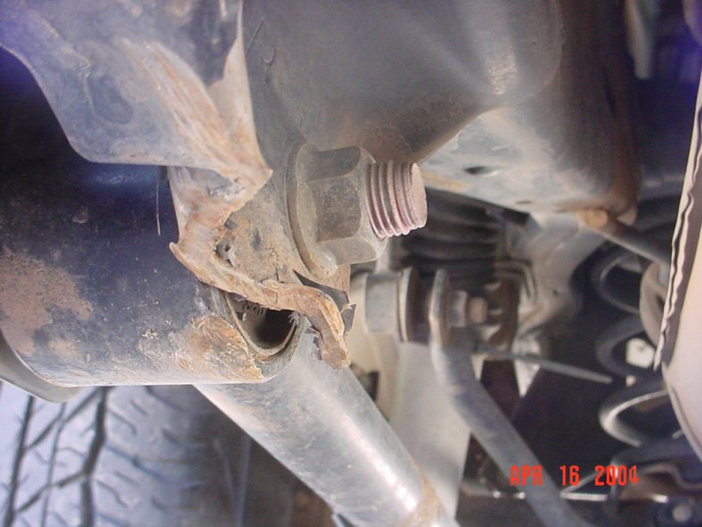

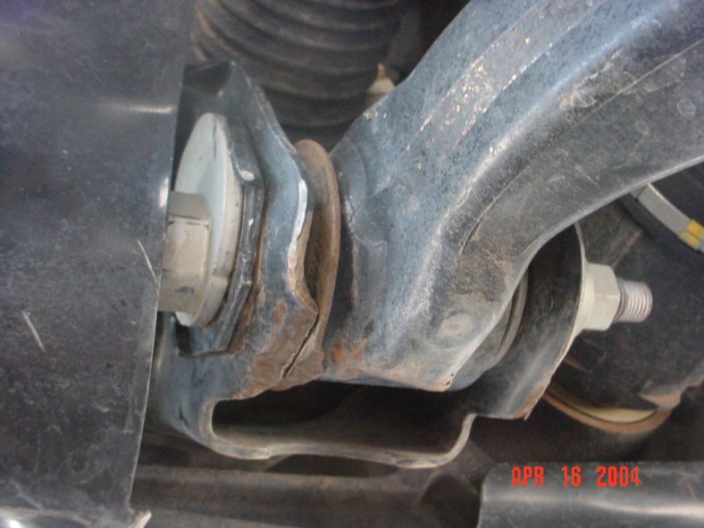

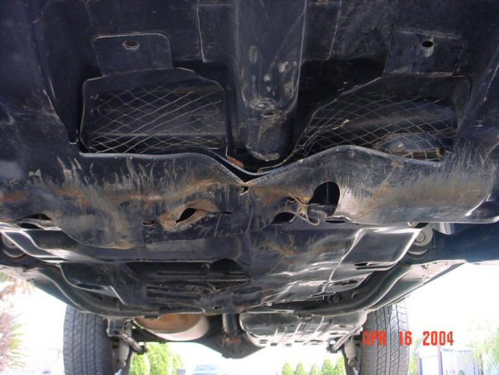

and another...the next few are what happens when you take a stock 4runner into a mild rock trail....this is why I lifted my yota
