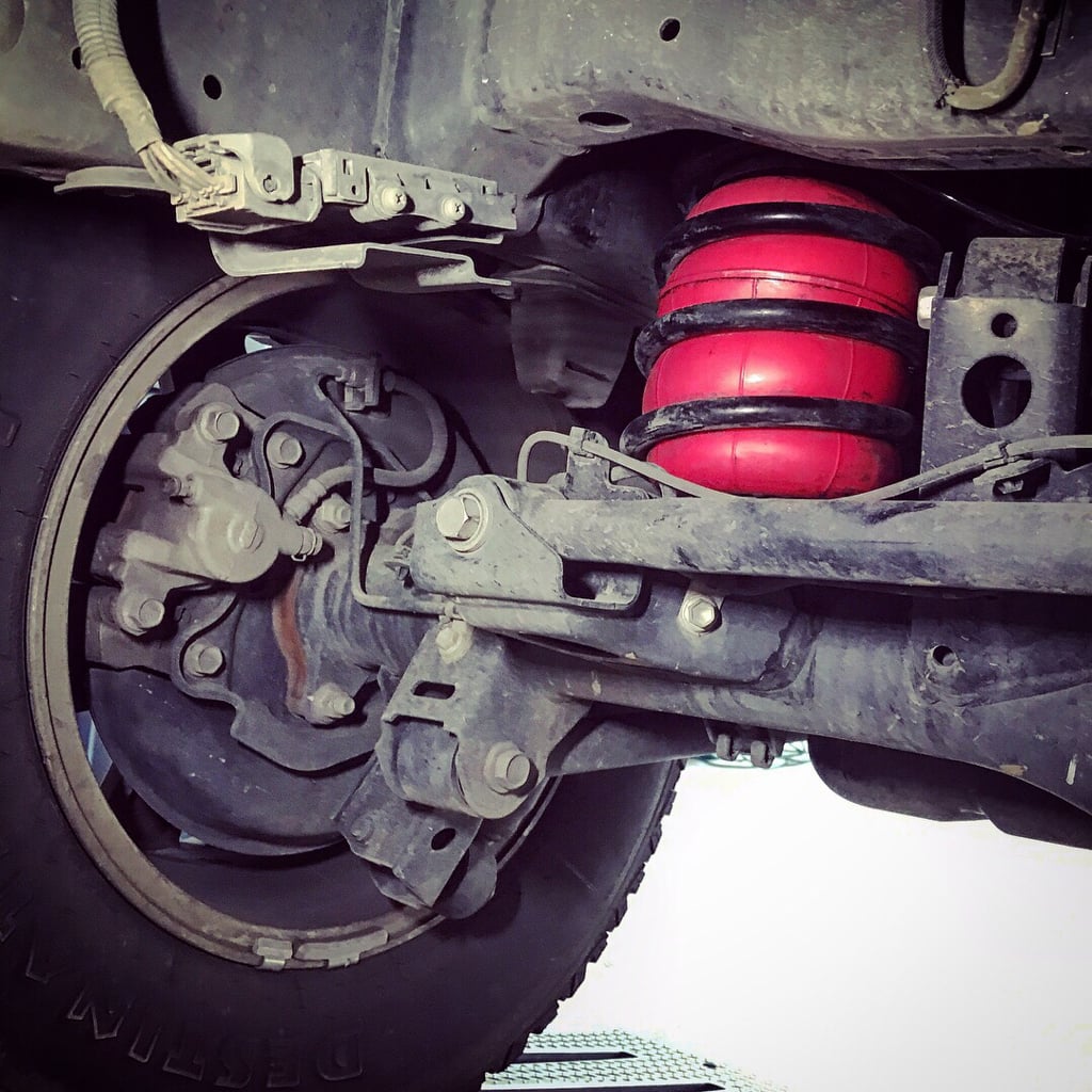

i have the load level airbags in the rear and they work great for the occasional fully loaded road trip. i take air out for daily driving and pump them up if i know im going to load the 4runner up or hook a trailer to it.

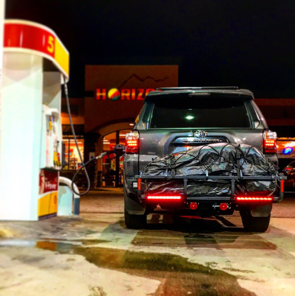

Without the airbags, this load would be sagging 2-3 inches and we would hit the bump stops often...

The goals for my truck seem pretty similar to yours. I wanted to keep a suspension geometry close to stock. Bilstein 4600s on stock coils (tall 99's in back) have worked out great. I also used the AirLift bags in the rear coils so I can adjust when loaded down or using a hitch carrier -- they are awesome!
