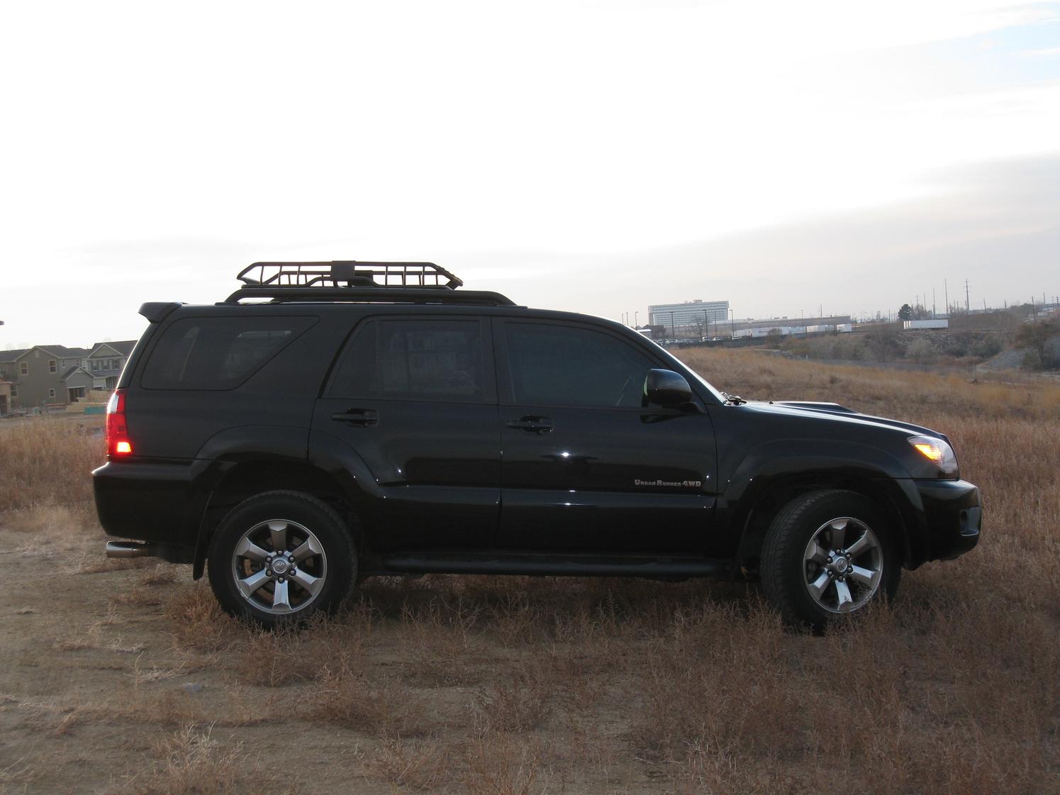

BTW here is a picture I took today with my new Roof Rack....
That's a good lookin 4runner! Everyone has their own opinion about what looks good, but imo anything over 1.75 would start looking nose high. Try the jack trick and see what you think. There is adaystar spacer that would give about 2" lift and a 1" toytec both in the classifieds right now, both at decent deals.
