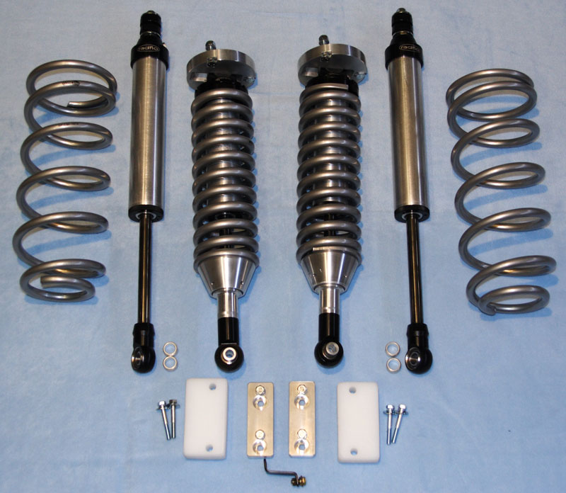

Cough up the money and put these Radflo's on.

Little pricey, i think he would be better off with the toytec ultimate lift for much less and still great quality that will improve the ride
Both are great quality, but are ultimately very different products. Since he doesn't wheel, it does not really matter, but the Rad Flo uses 2.5 diameter shocks, compared to the Toytec 2.0, and the Rad Flo are rebuildable/revalvable, while the Toytec are not. Also, the Rad Flos have been specifically designed for 4Runners, which is always nice.
