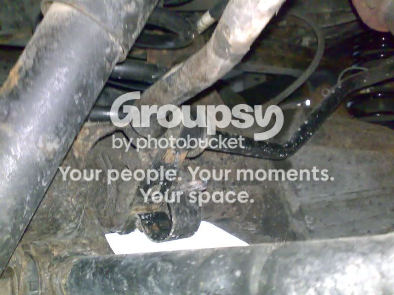

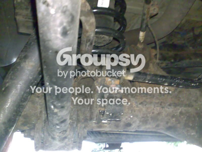

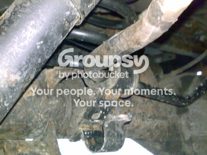

Can you guys tell me what this is and why you think it snapped off?
I just installed The OEM 3" lift kit a week ago, does it have something to do with this? Now this problem is lifting this side an inch more than the passenger side because of where it's jammed, that's how i noticed it.
Also i just did an alignment without knowing about this do you think i have to redo it after taking care of this problem?
Thanks

Thats your sway bar... which busted out of the bracket. I have busted mine a few times like that, but i have an extension i got with my lift kit. Get it fixed it will probably mess with your handling. A bracket is about 15 dollars or so at toyota, and dont lose that bushing they are about 20. You probably wont need to get an alignment. The reason it happened was probably because of you flexin the truck out all hard, thats how i always break mine
