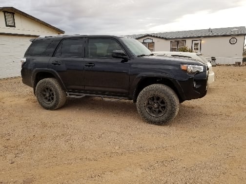

patkelly4370
I'm planning for the future.
2017 SR5. 22,000 miles on it. Bought it used from a Toyota dealer 2 months ago.
It is stock with the exception of:
Nfab nerf bars/step,
285/70R17 tires on Mickey Thompson wheels,
1½" leveling spacer on top of the strut.
I live in (very) rural Arizona. The majority of our roads vary from washboard dirt to undeveloped. All have washes crossing them, some extremely large.
My drive to work (1-2 times per week) is one mile of washboard, cross 2 washes. Then ¾ mile of paved County road (2 more washes), to 18 miles of State highway (65 mph).
I bought the T4R for commute to work and exploring trails on my days off. Also, temperatures here range from 20's for a week or so in winter to over 100 for 6 months, a month over 120.
I'm not looking to conquer obstacles, trying to see how tough the Toyota is. I'm not pre-running open desert. Just exploring, slowly, but willing to 'push it a bit'.
I will be going full steel skids. SSO bumper, add the 'wings' if/when I damage the front corners. Moving the spare to a receiver carrier. Replace the nerfs for sliders if needed.
So what do you suggest? I'm thinking remote reservoir shock because of the roads and ambient heat, especially on play days at the very least.

If the roads are that easy I would just get bilstein 5100's wwith fronts adjusted higher and some rear spacers/springs.
Adding the SSO bumper and skids are also not a worthwhile investment for you imo as those roads arent bad at all. They will probably barely even get dirty. It would just be unnecessary weight that will hurt your gas mileage for no reason.
I have 5100's with OME springs and may upgrade later, but they do fine for now. When I go camping, some roads are like that and maybe a little more worn down and I can go 50-60mph with no issue.
Terrain like that begs to be driven at a fast pace. If you can go'with kings with remote reservoirs and a long travel kit. It's pricey like a good vacation but worth it.

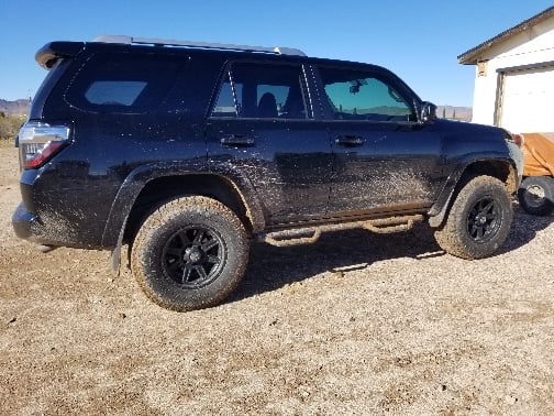

I like the stance of the truck. The spacer leveled it correctly to my eye.
The 285's also seem correct. They used to rub the inner fender ever so slightly. That has been addressed and is no longer an issue.
I like functional components. Though there is the benefit of a bit more ground clearance up front, I consider the spacer cosmetic. I would prefer that 1½" to be functional.
Upon reflection, I don't think I need to go higher. My "go fast" days are behind me. Now it's go slow, don't raise dust, what did I miss last time.
Quality shocks with soft springs should help keep my tires planted as I shuffle along. E-locker in back + Atrac should give me 3 wheel drive (2 back, 1 front tire) to maintain the shuffle.
Armor the underside. Replace the Nfab nerfs with sliders. Replace plastic bumpers with metal if/when damage occurs.
A basic outline, subject to change.
