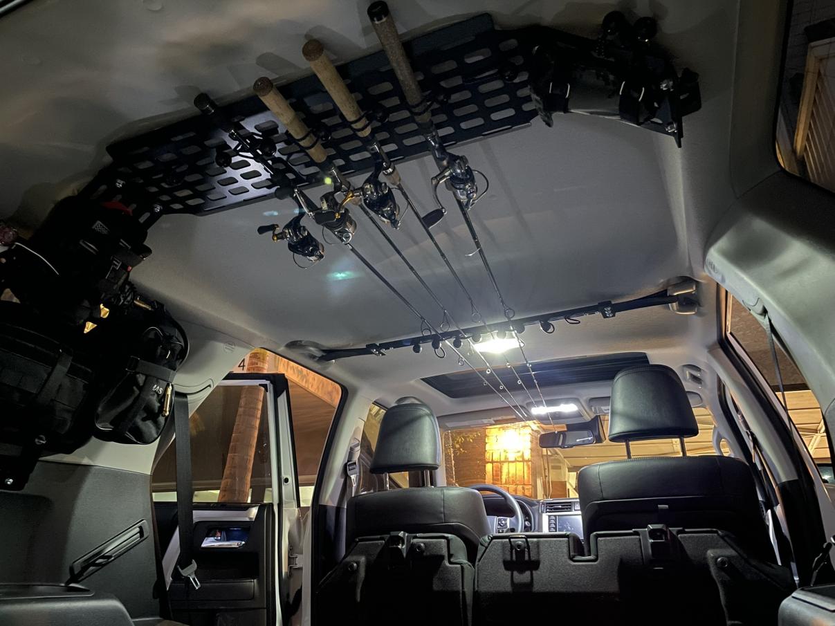

Molle panel and upper Molle
• Brand: Tac1
• From: Tac1
• My Rating: 5/10
• Would I buy again? Prob not, different brand yes, prob would have done rago
• Notes: not the best fit as far as angles. had to bend each bracket 20 more degrees, that’s not easy. Also switched out the 1/4 fasteners for M6s, why mix types in a truck that is metric? Rattles. But. I really like the roof Molle for fishing rods. So. Meets my needs. Fasteners droop, and rattle. I’m an engineer and have ocd. This drives me nuts.

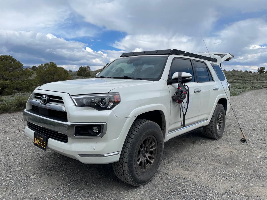

Roof rack
• Brand: Prinsu, full length no drill
• From: Prinsu
• My Rating: 8/10
• Would I buy again? A rack? Yes. This one? On the fence
• Notes: modified mounting for no silicone. Search no drill no silicone thread for details. I Very much like the prinsu profile vs others. 2” cross bars better for my needs than some others which are 3” a few taps were short, and one of the large fender washers rusted in 1 year. In socal.

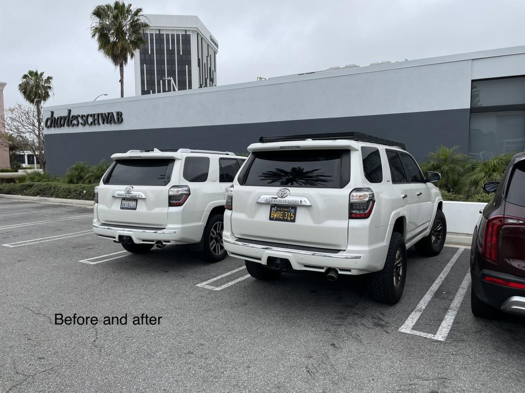

Suspension
• Brand: Bilstein 6112/5160 @ 2.75”/2.0” height + SPC UCAs
• From: Bilstein and OME, via 88Rotors in LA
• My Rating: 10/10
• Would I buy again? Yes!
• Comments: Really like the balance of city/off-road. Was XREAS which honestly was not bad. Super plush on washboards.
Tires and Wheels
• Brand: Icon vector 6, Toyo AT3 P285/70R17
• From: Icon, Toyo via 88Rotors in LA
• My Rating: 10/10
• Comments: quiet, combo same weight as stock. Required fender liner mod, mud flap delete, and for me a BMC. I think I could have pushed the caster forward and avoided a BMC but, now any idiot can do an alignment without worry.

was the third row seat an option in the limited model for 2021? I never have seen a limited without the third row. I noticed your second row seats fold up like the 2 row configurations. did you change the seating at all?
nice write up
nice write up
3rd row was and still is an option, when I bought only about 1 in 20 came without. I stalked inventory until I found one without. No mods.
