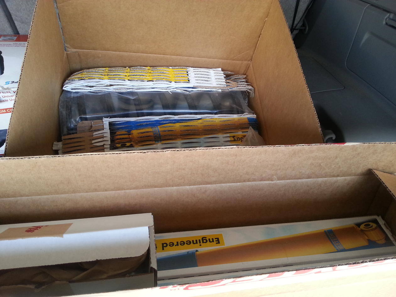

It's here! Getting done tomorrow, can't wait!

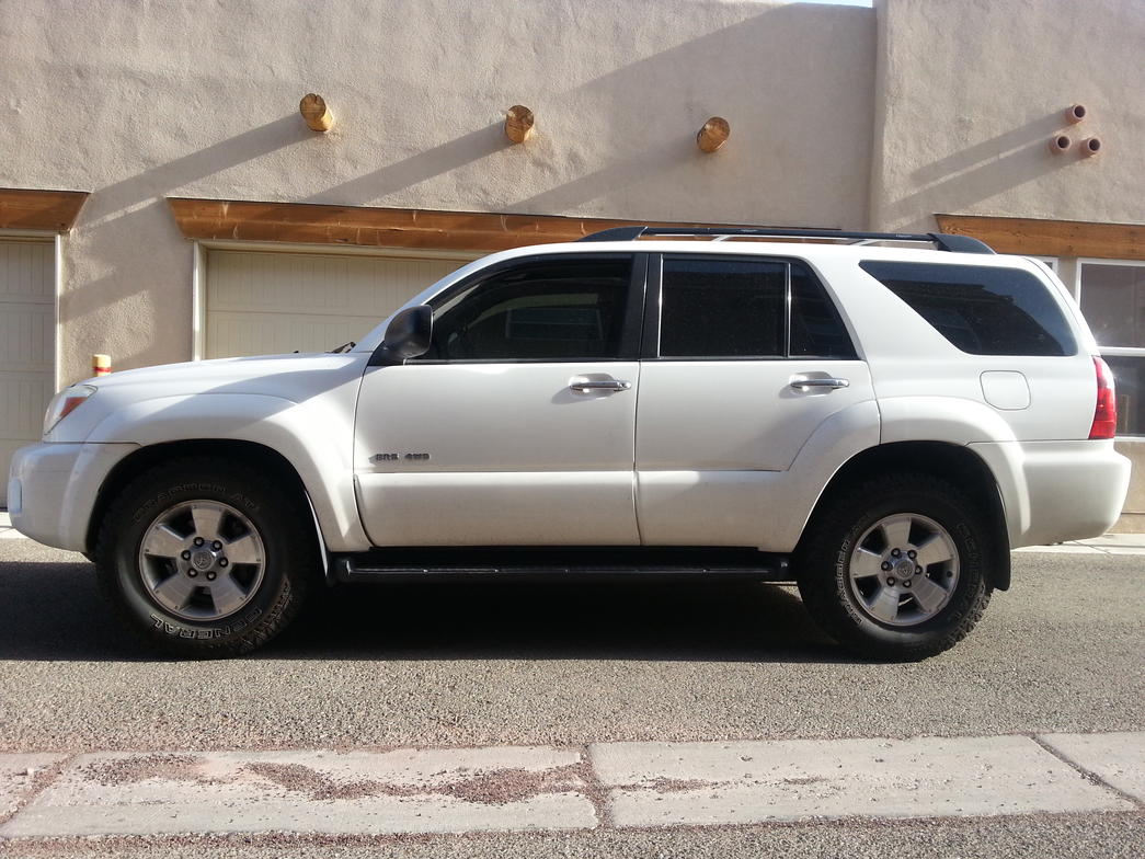

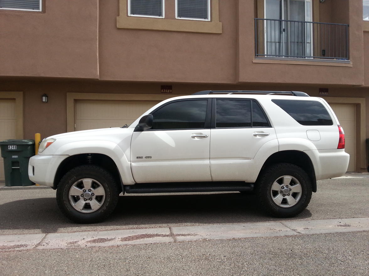

Before and after pictures, She rides like a dream, better than stock suspension!
