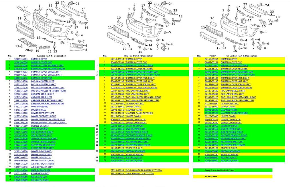

Looking to swap my front end from the limited I have to an SR5/Trail.
I found a few threads on search but didn't see a detailed list of what is exactly required.
I believe some of the mounts/clips won't line up exactly for just replacing this part, seen below.
Can anyone provide a list of the parts?

Updated post so everyone can see what it takes.
I also added the TRD Front Swap Information.

If I'm reading it correctly, to change the front bumper and grilles on my limited to the Pro, I would just need to purchase the yellow items in the middle column, correct?

That is correct. However there are a couple other parts that are needed which total about $100.00
It's not a cheap swap, you're approaching after market full bumper money unless you go used.
About $1400 dollars to do the swap and if you want the TRD Garnish and Upper Grille add another $600.00
Plus Paint & Labor.
You can save a few dollars by locating a front bumper support that someone is removing so they can install a steel bumper.
You wouldn't happen to have part numbers for the other parts that are needed, would you? Or what they're called, and I can try and track them down.

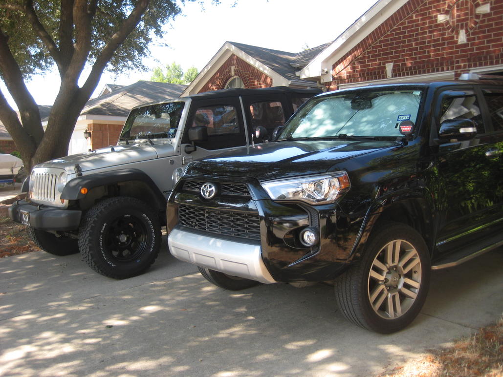

You are on the money. I had to drop a little more as a result of headlights etc. I don't suffer from hood scoop envy like I did on my 3rd and 4th gen so went with the reg hood. Love it better now then with the Limited frontend

Like this. I'm not loving the limited front.

It's fairly simple swap and if you have basic knowledge of how to use hand tools you could easily do it.
Heck putting in a new garage door opener over the weekend took longer then the front end swap.
