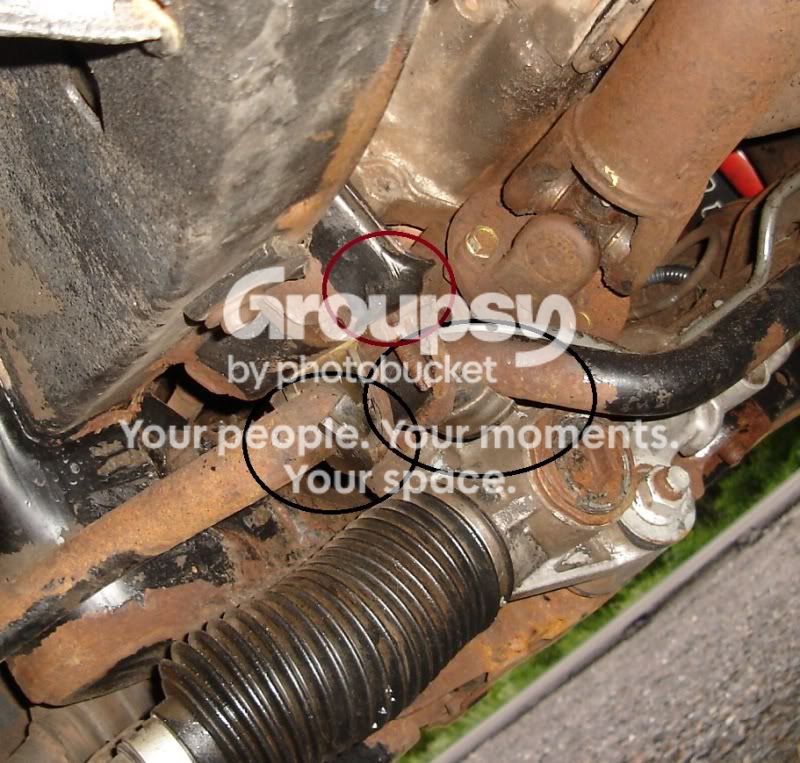

One is cracked and working its way out. I'm gonna go and see about getting it fixed (and I don't want to do it myself as the bolts are ****ed).
My usual shop is WAY busy right now, and I hate going to other garages because everything is always double the price one would reasonably expect. You need this and this and this done, too, and we have to do it this way, and it's going to take longer than we thought, etc., etc.
How much should it cost to get this fixed? And, would a sharp metal clunk sound while turning right be caused by this bushing (the bushing is on the driver's side)? Always sounds to worry about.

The sound is probably that bushing. Mine clunked like that when it got loose before and yours is shot. It takes about 5-10 minutes to replace both of the mounts yourself, even with the rust. If you break the bolts, it'll just fall off. Buy new mounts, new bushings, 2 screws, 2 nuts and you're good (the other 2 screws and nuts are already attached to the new mounts). I got all that stuff a few months ago from the dealer and it was ~$50 for everything.
Yea I would do this job myself. Pretty easy to do. The bushings have an opening so you just slip it around the bar. No need to remove anything else. Hit up the dealership or Napa for the parts.

Just replaced my sway bar bushings after replacing end links about a month ago. The underside of my Runner looks like yours Maritimer, typical northern rust everywhere! The driver's side was a piece of cake (with a good shot of PB Blaster) and I was able to replace it in about 10 minutes. Passenger side was a royal PITA and rusted tight, I couldn't get a good grab on it with the exhaust in the way. Had to take it in to get done at my mechanic. All-in $40.00 Canadian for the OEM parts and $20.00 to my mechanic. Was expecting a huge difference in the way the front end feels but not really that noticeable still glad to have it done.
