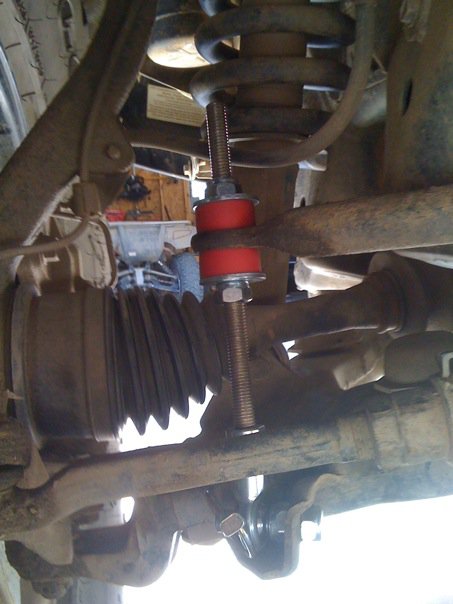

**** The excess has since been trimmed off the top of the bolt ****
I can remove both sides using a 19mm socket/rachet in less than 5 mins...
Top notch parts from a great guy to work with!

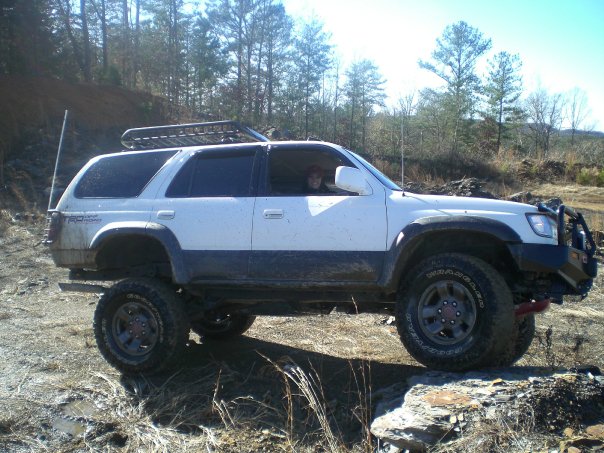

More flex up front...
Same "Poser Rock"...
First pic is with sway bar connected, second is disco-ed.
You can def. see a difference in the front tuck...
