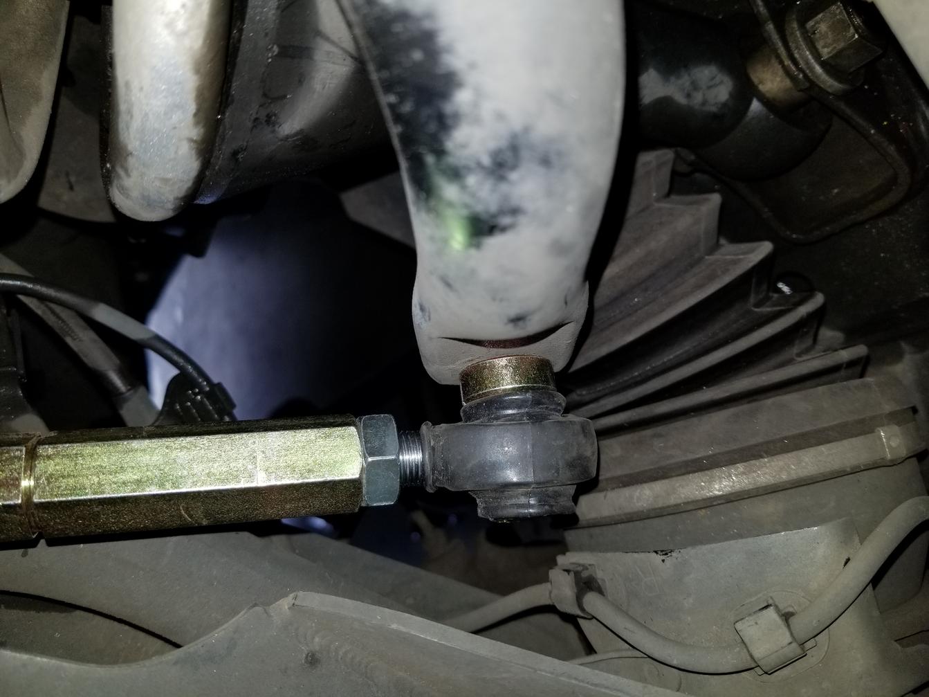

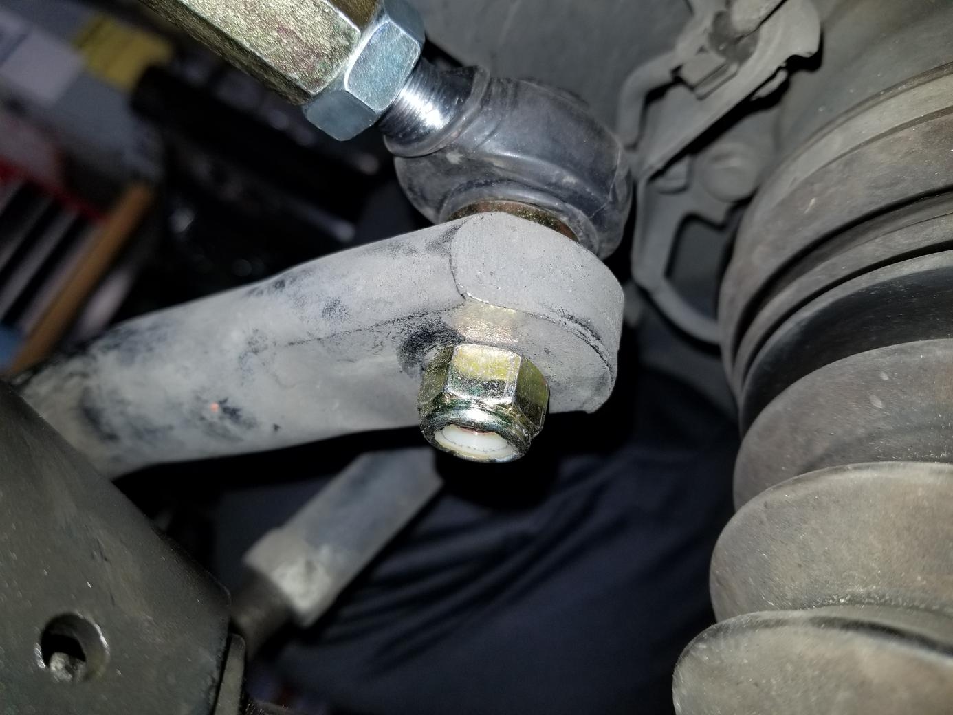

Anyone else's front bolt too short? It needs to be maybe 1/4" longer.
I can send out longer bolts if you or anyone else need them. Those are the same bolts that I've been sending out for 4 years, and haven't had anyone say anything about it until now.
I can send out 2-1/4" bolts to anyone that needs them. Or, if you can find 7/16-14" x 2-1/4" Grade 8 bolts locally (Ace Hardware) I'll refund you the money you had to spend.
Mike
Mike
If I have a problem, I'll handle it myself. No big deal.

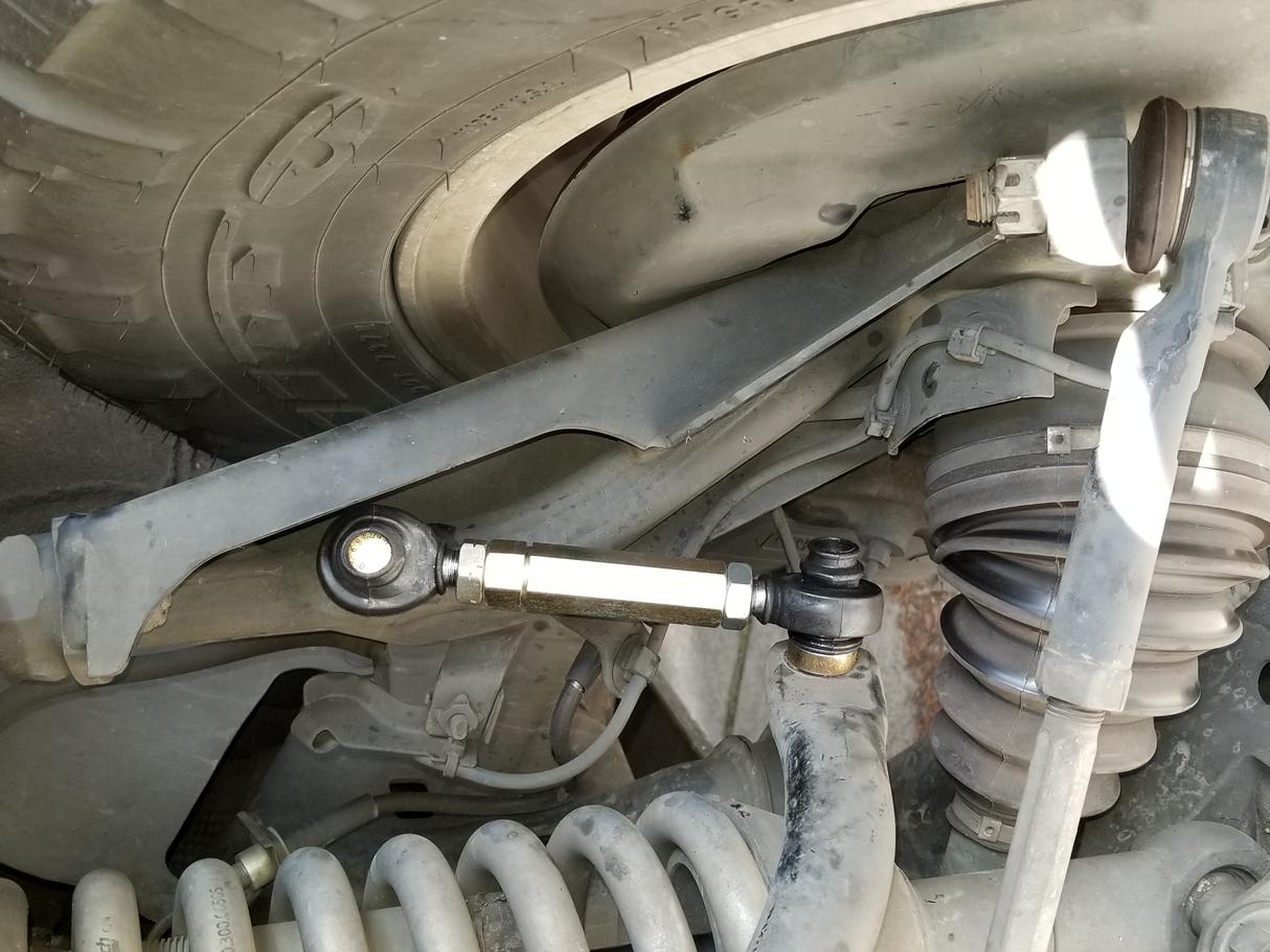

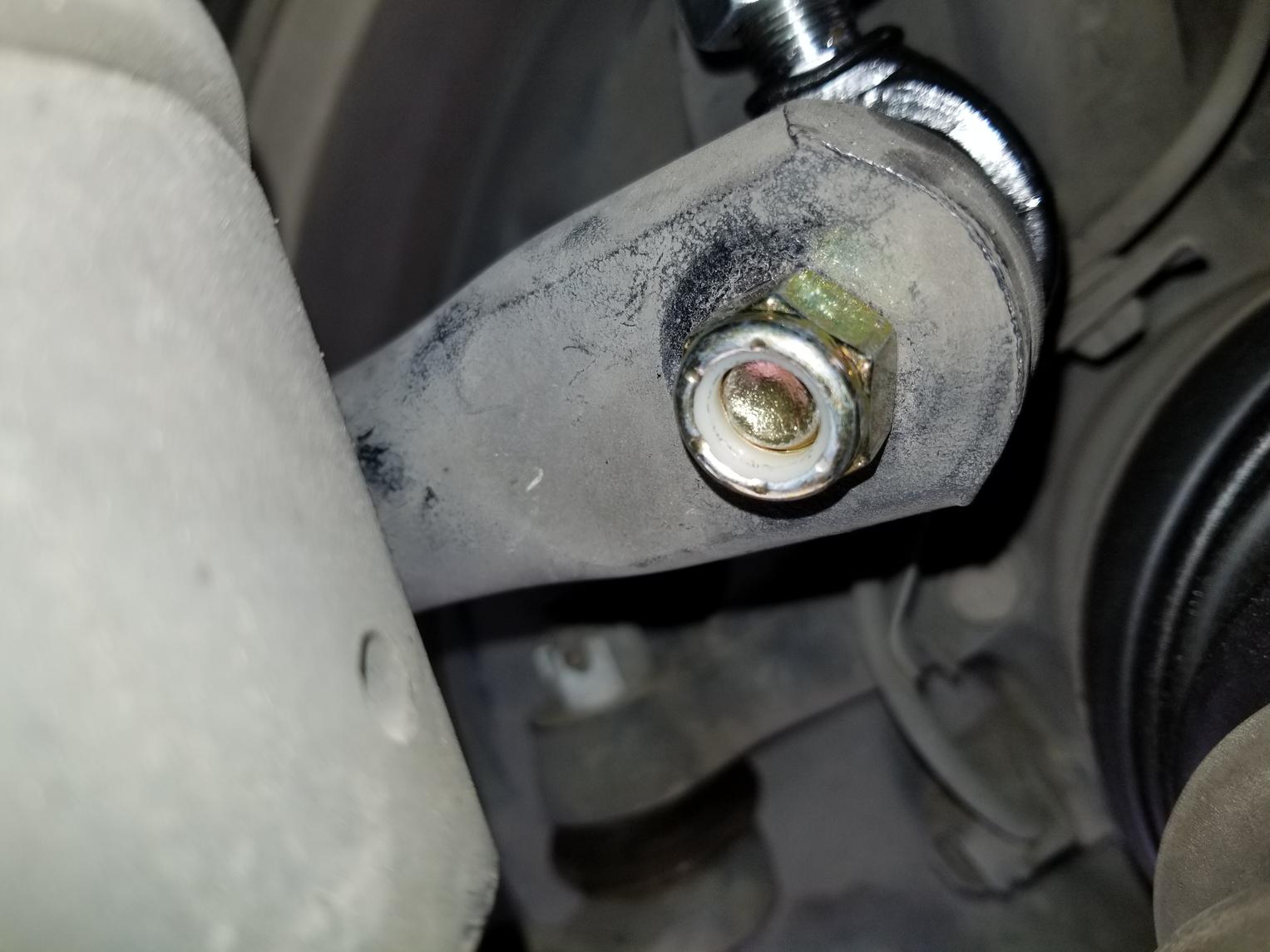

You can see here the bolt. I got some 2 1/4", cost me $1.50 and worked perfect. Thanks for the links @MTstudt! Look and work great. Yahoo for no more tweaked rear sway bar because of the super short stock ones!
