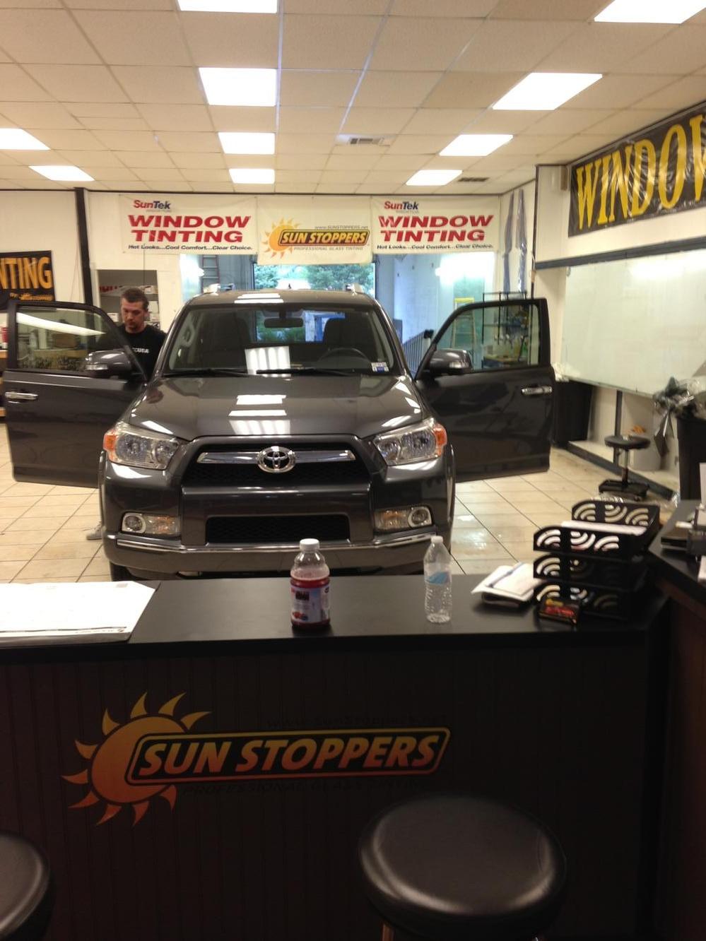

Here she is stock getting tint.

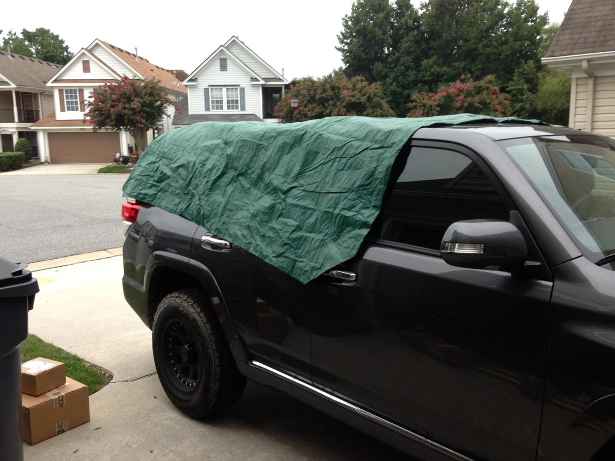

This is what happens when you're installing the Gobi outside and it starts raining. Note the icon box in the corner :)

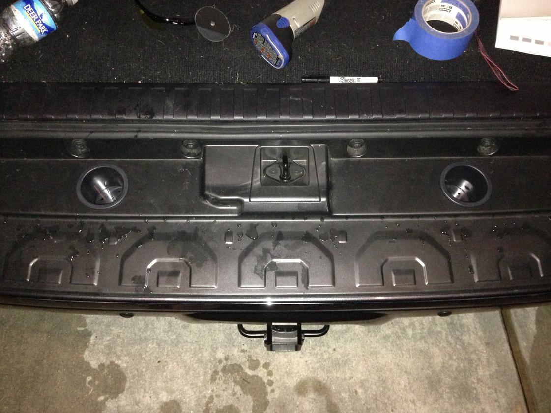

I'm uploading pics from my phone so stay tuned for several pics of the cup holder install. This was my first "big" mod (i.e. big in my head because I am taking a power tool to something so expensive), but it turned out great and I'm happy with it. It's a decent mod that stays outta the way but is still really convenient when the opportunity arises. Props to antman all the way on this one, both for coming up with it and answering my questions during it.
Measuring/marking. You can see the spare through the hole.

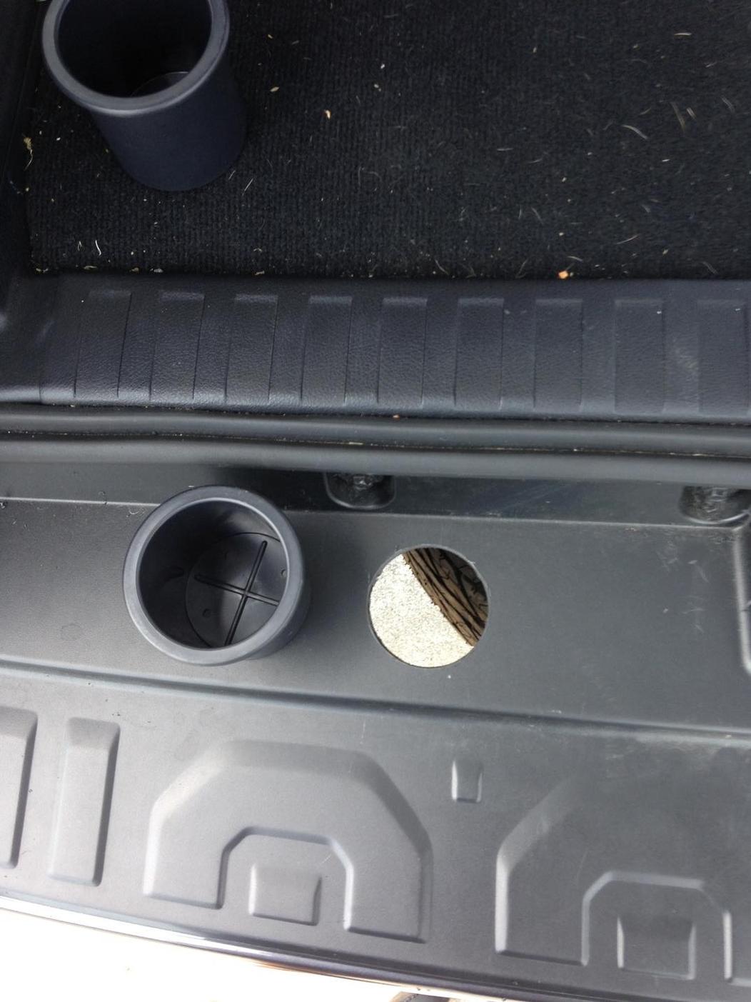

This is becoming really disorganized sending from my phone, but I followed Antman's advice and used a hole cutter for a drill smaller than the diameter of the cup holders... that way you can Dremel the holes to size for a tight fit. I have not put in any adhesive or sealant to try and adhere the cupholders to the bumper, and I see no need to. If you Dremel carefully/slowly, you can get quite a good, solid fit without needing to use any silicon.
Also wanted to add... I originally wanted to put the cup holders in closer toward the lift gate latch in the middle, but the spare tire underneath will not allow it. Measure twice, cut once.
These cup holders work with my Gobi ladder currently installed (pics to come), but the clearance is without a doubt CLOSE.

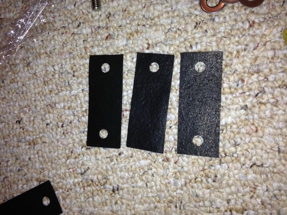

Pre-staging hardware (a very good idea) and noticed this. Little oopsie but no big deal. Used another as a template and carefully drilled the hole into the rubber.

I put on all four rear brackets as noted in the directions. There should be a little overlap on each side of each bracket with the weather strip.
