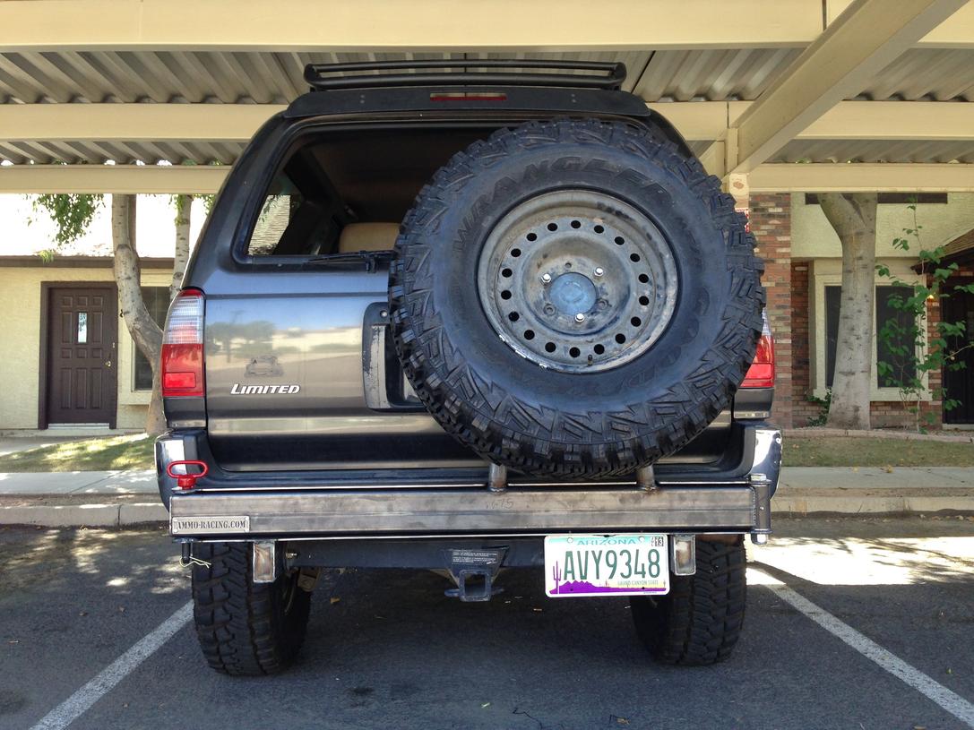

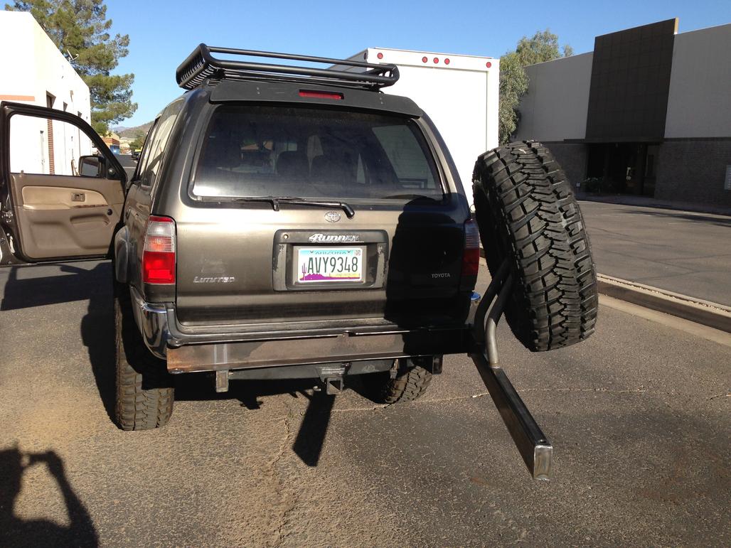

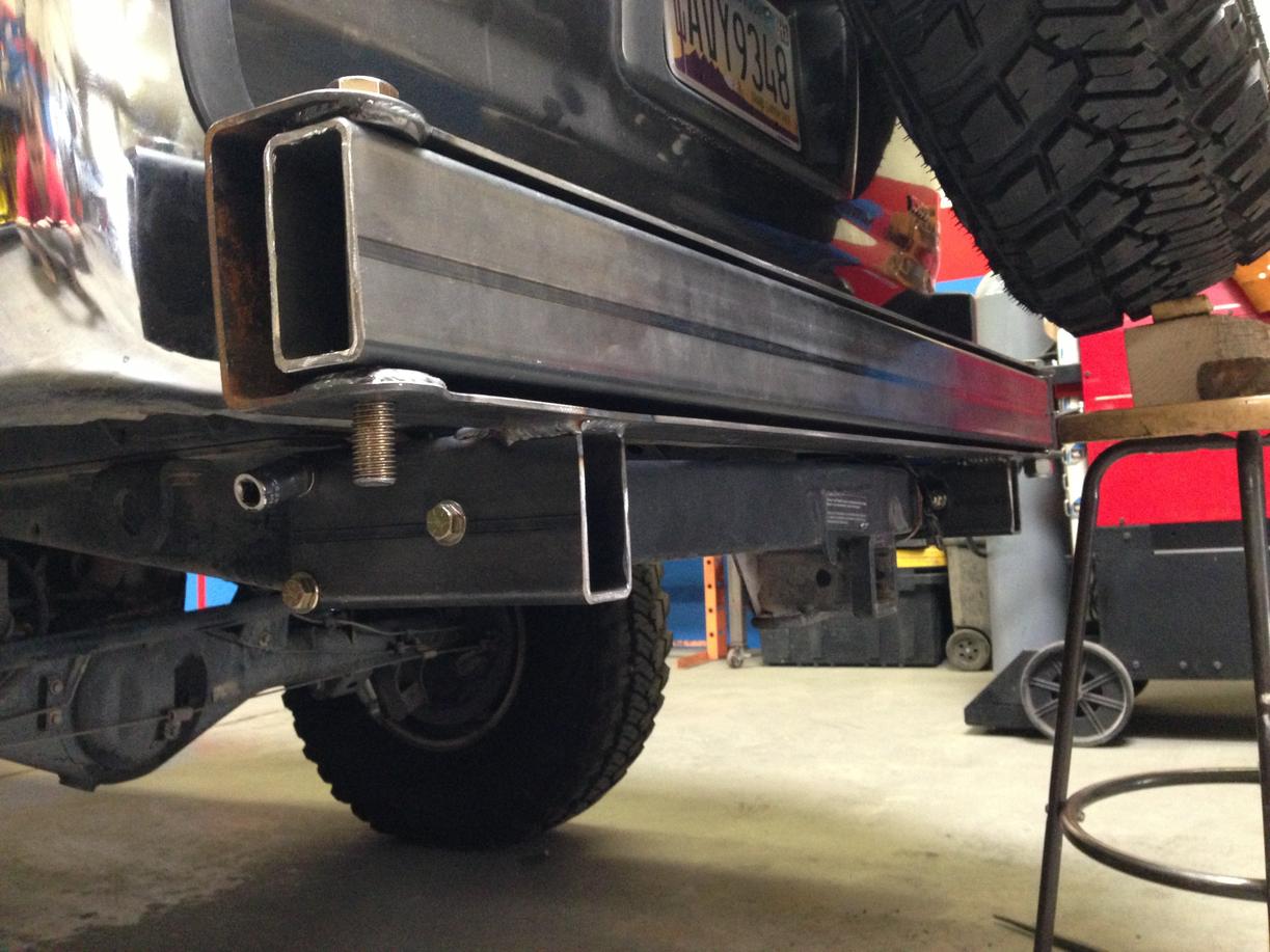

I decided to do a tire carrier off my stock tow package. Bolt on! Pretty sweet! Little minor reinforcement to do so I could actually stand on to open but solid right now for all intents and purposes!

Yup! Going to reinforce a little first. Thinking modular, obviously need to mount my hilift but ice chest, BBQ grill, gas/water cans etc. things to suit different trips. And thx btw! I think it turned out pretty good.

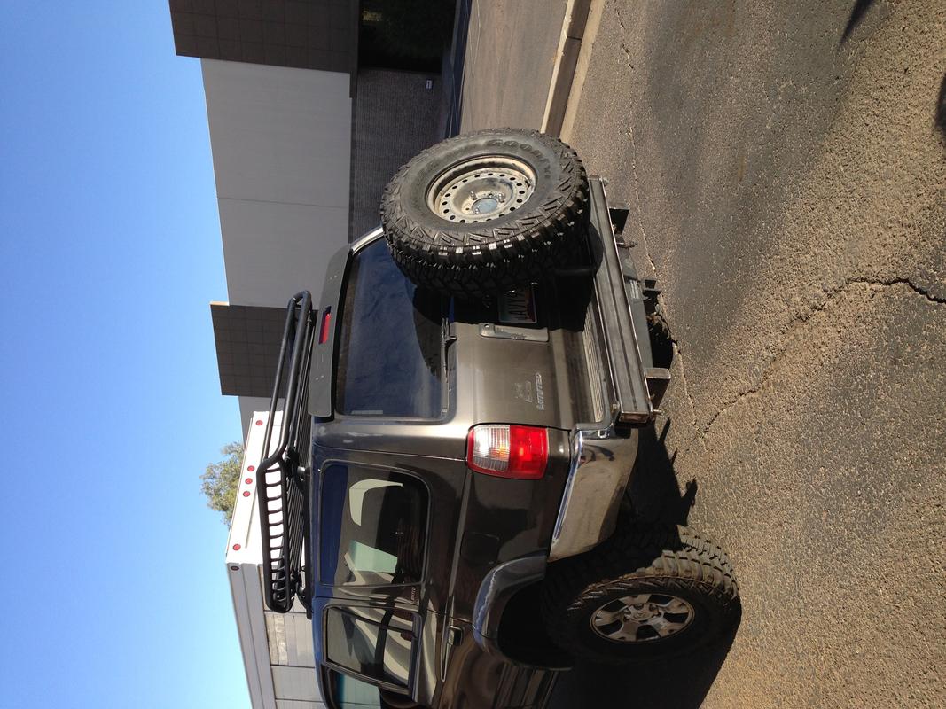

Will do ghost, already went camping with it and drove rough roads for hours with no issue.. So far so good!

Just google search swing out tire carrier hinge, I chose the double sheer with 1" tapered roller bearings.
