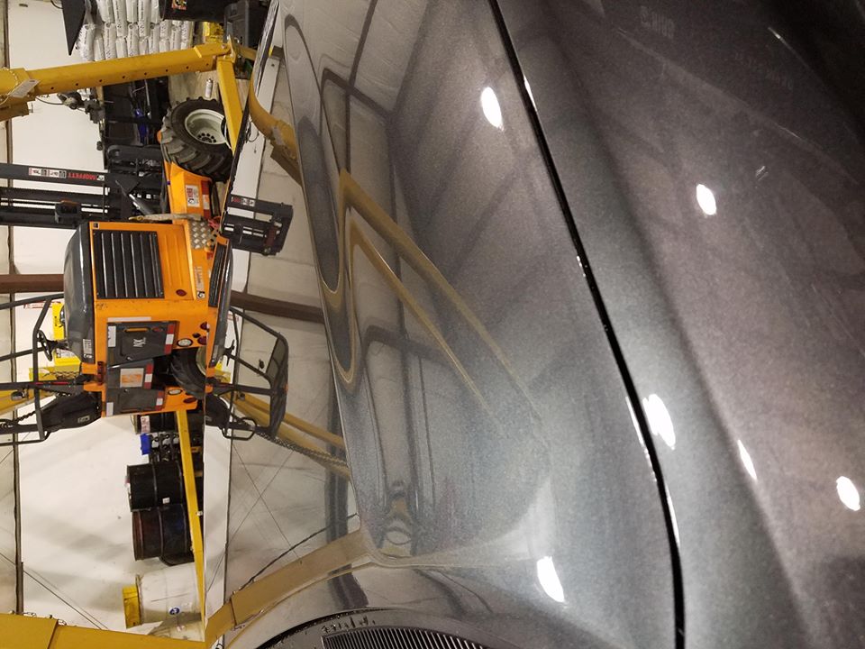

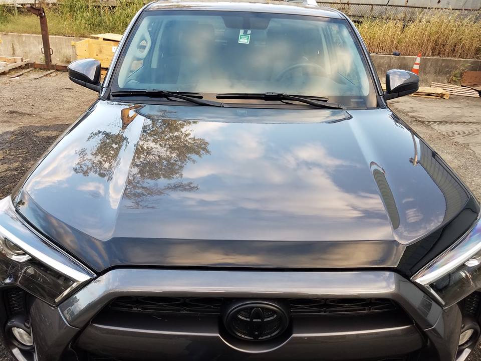

My years of detailing experience have pushed me to Meguiars products. Their products have always done very well for me. Wash, clay, wash, wax, twice a year on all my vehicles. Always by hand, I never use any electronic buffing wheels or anything like that. My specific wax of choice is their #26 Hi Tech yellow paste wax. Plenty of great products on the market, this is just what I have grown to love.
