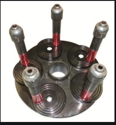

Here is an image of the tool local shops need to balance Toyota truck wheels. Sometimes called a finger plate adapter.

The stock wheels are hub centric. The purpose of the Haweka (finger plate) adapter is not for centering the wheels on the lugs, it is for putting even force as if the wheels were bolt onto the car.
Your problem is the crap stock tires. No matter how much you road force balance with the finger plate adapter, you will still have some vibration. If you value your time just get new tires and be done with it.
huh? the stock wheels are hub centric, right? they just use regular washer style lug nuts, how could they be lug centric without tapered lug nuts?
If the mating surface of your lug nuts are conical you have lug centric wheels. If the mating surface of your lug nuts are flat you have hub centric wheels.
The stock wheels are lug centric. The purpose of the Haweka (finger plate) adapter is not for centering the wheels on the lugs, it is for putting even force as if the wheels were bolt onto the car.

I wasn't thinking clearly and said the stock wheels were lug centric in the original reply, but they are actually hub centric.

To improve the accuracy of Dynamic Off–Car wheel balancing on all OEM Toyota five and six lug
wheels, a precision wheel adapter kit must be used. For the greatest accuracy and repeatability,
Toyota recommends using the Haweka adapter kit available through the Toyota Approved Dealer
Equipment catalog. The kit consists of a precision ground centering cone for truck alloy wheels and
a flange plate
https://www.ih8mud.com/tech/tsb/ToyotaLandCruiser/tsu00296.pdf
You can keep getting RFBs but that won't fix the vibration issue. At least try the flange adapter if you want. I have personally seen the difference and believe in the flange adapter. To each their own...
