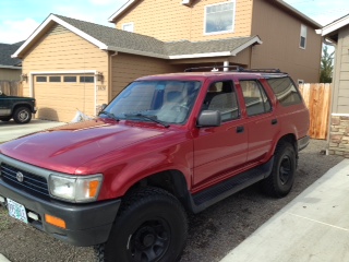

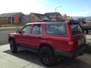

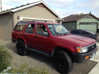

Hello,
I am the new owner of this 2nd generation (1993) 4Runner.
She came with a lot of documented rebuild on her - engine, clutch, etc but I have found a set of the factory manual hubs with all the hardware and wanted to ask if there is anything else I will need to do the conversion?
I am still looking for the factory manuals as my rear door window key does not respond to either turning it left or right. The window stays up, but the switch on the center console works fine.
Any input is greatly appreciated!!
Thanks
