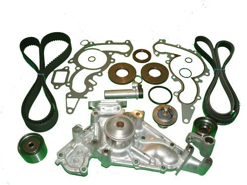

$850 thats aint bad at all, I was more thinking like $2000 considering the parts alone can be well over $400. Not sure if timing belt kit from e-bay below has everything included or not
Timing Belt Kit Toyota 4 Runner 2003 2004 V8 2UZFE 4.7L: eBay Motors (item 170429983508 end time Jun-07-10 14:53:17 PDT)
or should I stick with OEM parts? :confused:

I'd do it. Chances are many if not all of those parts are from the OE vendors. It looks wonderfully comprehensive and complete. Those are all items I'd want to replace and I'll bet many dealer jobs don't put all those components in... To my knowledge Toyota doesn't 'bundle' a kit and therefore I'd bet what's replaced, I suspect, varies dealer-to-dealer, shop-to-shop.
I'd also type "Timing Belt Kit Pro sucks" into Google and see what comes up.

:iagree: and I also have the philosophy "while your in there do it. It's such a PIA to get in there!" An exterior idler, accessory belt etc I don't care. I'll deal with those as they come up. BTW, I Googled Timing Belt Kit Pro, looks good to me, I'd definitely take that route.
